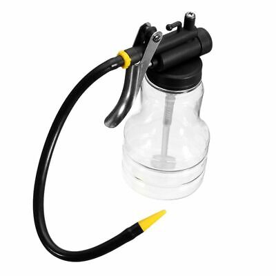

I have just bought this, arrived yesterday, filled it with a strong mix of water and washing up detergent. Seems to work well on roof drains and the side sliding windows - although because it not pumping oil it may fail in time (and you need to get the knack of the pump before inserting into the drains holes):
