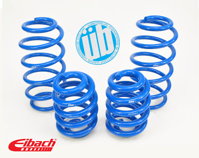

Skewif, I want to raise the rear of my 4 motion, which springs did you end up using? I'm in NZ so a specification of the spring would be even better than a VW part number as 'VW tax' is strong here :)
Cheers (your setup sounds great!)
I used Pedders ( made in Australia) and still very happy with them. They did lift the rear some 50mm though which made the van too nose down so lifted the front 30mm to compensate.

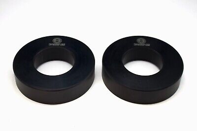

These may be of use for front & rear. you can get spacers for the rear only. Various available
Why just the rear?
Unfortunately the authorities here have an aversion to spacers. It would fail its ‘mot’ if fitted.
Can I ask which actual products you specified as their website is not at all helpful in detailing the specs of the products! https://www.pedders.com.au/catalogue/springs/volkswagen#
I think you mentioned Sachs dampers too?
My plan is to start with the rear springs. Evaluate, then progress perhaps with rear dampers and then front bushes, springs and dampers as necessary and the same as you. I’m sure sidepod means well but perhaps we are starting from a different place than he anticipates. Ie, the std 4motion California is not fit for purpose when loaded (and carrying heavy ebikes on an extended tow bar mounted carrier in my case).
pedders-heavy-duty-coil-spring-7891.html Unless you really want to raise both ends of the van for ground clearance then T32 rear springs and really good HD rear shocks will give you a superior ride and load handling without needing to change anything else. I would change the rear shocks to something decent first because if your van has done a fair few miles or you're real heavy it will transform the handling and ride under load. I have Sachs HD super touring shocks on the front and Pedders HD shocks on the rear. The Pedders are now getting a little soft for my liking so going to try some Koni Active shocks on the rear soon as heard nothing but good reports. Hope that helps
Yes thanks, most helpful. I’ve just been on the phone to the NZ disti and ordered the springs. I’ll evaluate first before buying dampers. The van has only done 25k miles. Cheers for help, james
