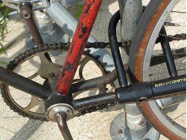

Small D locks are more secure as there's less purchase. No need to go around the downtube either; lock the rear wheel somewhere within the rear triangle and the rear wheel cannot be removed from the frame without cutting through the wheel which would not be easy, especially if the bike is on a rack.
Two rear wheels locked to each other, through the rear triangle similar to the above, will secure both rear wheels and both frames to each other, as well as both rear wheels to both frames. Front wheels, saddles, etc., can be removed or secured separately, and of course, one or more frames secured to the rack.
