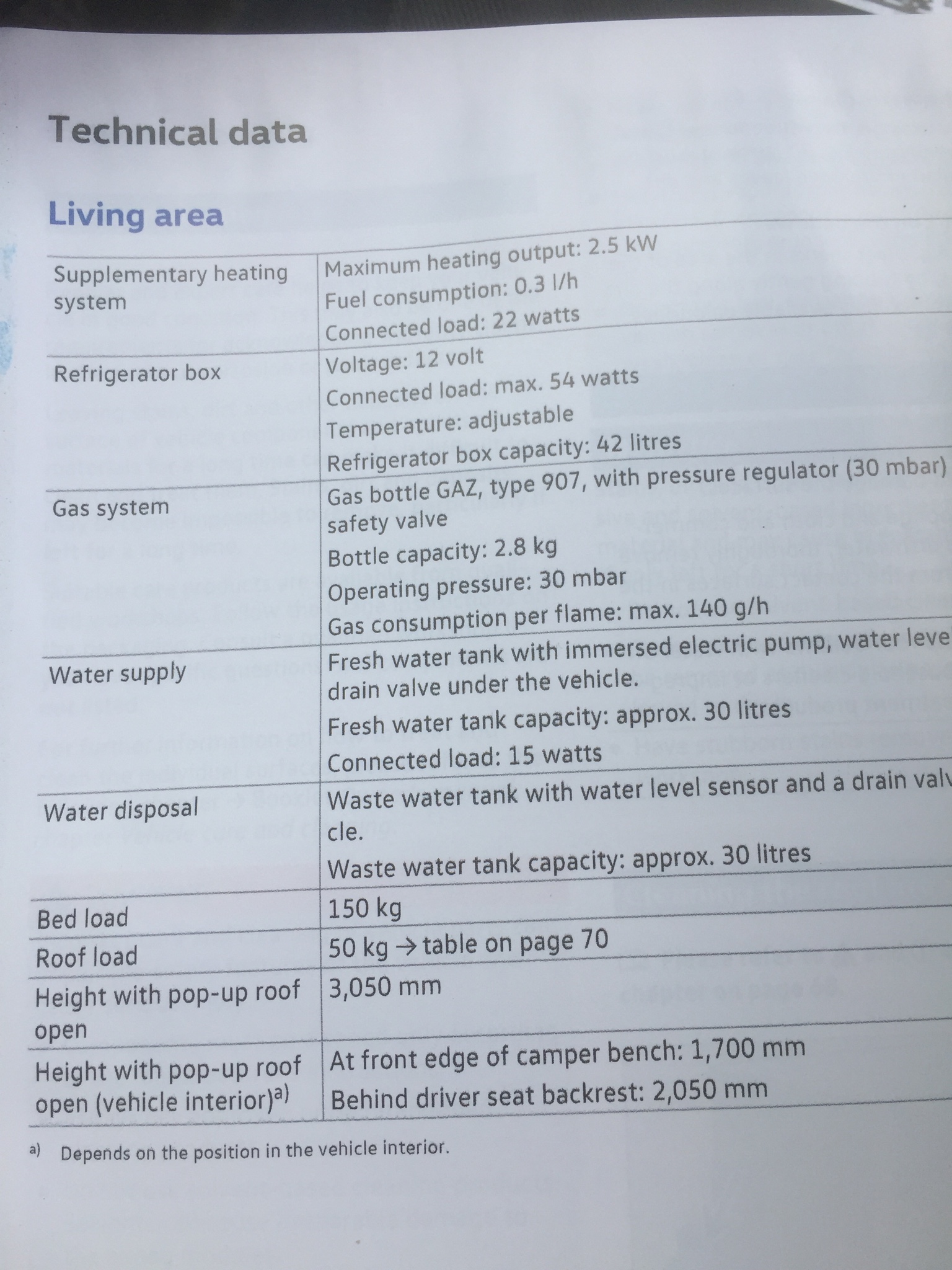

It is 250kg , was just last week reminded on this during the info-evening Campercentrum Nederland
Bed load 150Kg according to the manual!!!
Tom, thanks. I looked some months ago but must have given up or had one too many glasses of wine and just got distracted!! I wonder where the 250 figure came from then? :eek::eek:
I see above German forum and Camper Centrum (where I saw it too!!) both say 250.
Perhaps the 250 is a peak level! ;) (Sorry off topic!!)
Well, roof load 150 kg seems a bit low (with really all due respect).
But saying "bed load" in the "living area" do they mean the roof bed? Doesn't matter, it is too low for the lower bed either.
Maybe contacting VW (Ireland / Germany) might help to shed more light into this.
Sleep well....:)

I was led to believe that the roof bed weight limit was 150kg, which I always thought wasn’t much for a static load in a bed made for two adults.
I’m no automotive expert, but if motorhome design is anything like building design the engineers will build in a factor of safety on top of the safe working load. So the bed won’t just fail at 150kg, although I’d doubt this FoS would be an additional 100kg, but fingers crossed that this turns out to be the case...not that I’m porky!
Having looked at the design of the bed I’d be more concerned about the point load on the unsupported edge when clambering up and down. I wonder if anyone has ever damaged the edge slats in this way...
