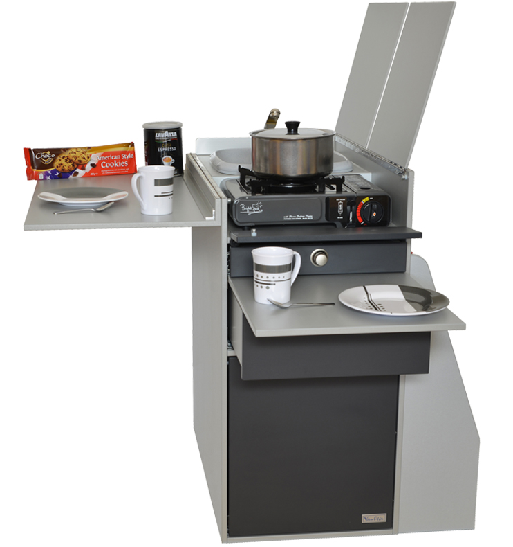

We have the 2 seater Beach and would be VERY interested in a pod that would fit behind the passenger seat but with the supplied storage box still in place. We'd still want to be able to make the bed up full width.
The pod below would be ideal for us as we have the very same fridge! ...Sadly it will not fit with a 2 seater Beach's storage box in place.
If you could make something like this in combination with a redesigned storage box ( so tha the full width bed could still be used as intended).
A sink is of very low priority to us. A single gas burner would probably be enough for us, 2 rings would be a bonus!
For us, we could even cope with having a slightly shorter mattress on the pod side.

I think that the heart of this pod will have to be a portable single burner compact gas stove.
There is obviously loads of the "standard" type about for around the £10/£15 but are they any good?? Regarding function and quality??
Has say one seen any higher quality ones??
