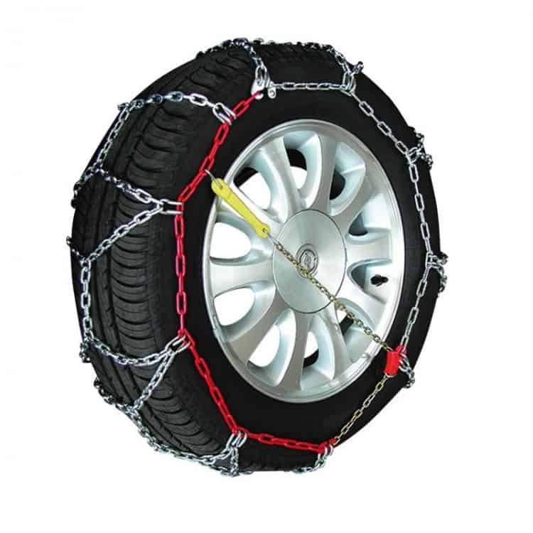

Hi all, now I never thought it would have been such an issue to find a cost effective snow chain for the size tyre 235/55/R17 we have on our Cali. If anyone has any second hand/new they're willing to sell please let me know. I've seen them upwards of £60.- £300 but I'm only likely to use them once for a ski trip in 3 weeks in Switzerland.
Or, has anyone used a slightly different sized chain on the same tyres and it work just as well for example 235/45/R17 or 235/50/R17 ?
Please let me know (I'm assuming given the weight of the Cali I'm better off with chains than socks if needed, no huge hills but possibly enough to need either) and I'd rather not change to all weather tyres. Thanks all

With 235/55 - the gap is very less - about 10 mm ... so I would be wary of chains that fit around the tyre. The chains that go around the tyre for this weight of vehicle, you will need at least 12 mm chains. Most of them are 16mm and will damage the shock absorbers.
The recommended ones are the Konig K Summit V k87, which are expensive at about 400+ GBP wherever you look https://www.snowchainstore.co.uk/konig-k-summit-van-k87

because the tyre is wide (235 mm) and the clearance between the tyre and the shock absorber is just about 10 mm (if the tyre is correctly inflated) , or less. For a van, the chains are 16mm or 12 mm min thickness and they will hit and damage the suspension components behind the wheel.
Put your hand behind the front wheel at the top of the wheel and feel around - the clearance is about 10 to 12 mm.
Put your hand behind the rear wheel at the top of the wheel and feel - the clearance is much less.

So I also found these, a little more expensive however safer I think that the first one (Approx £125) allows for zero clearance on the inside of the wheel, the second one has an allowance of 7mm clearance (£85) these were recommended by Pewag when you enter VW Cali T5 235/55/R17.
Hope this could be helpful to anyone else and thanks so much all for all of your input....
