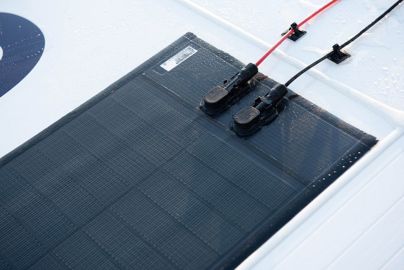

This looks very interesting, since the panels by this manufacturer are very light weight and can still function fairly efficiently at high temperatures, meaning air flow beneath them is not necessary. They are also wired internally so that if a few cells of a panel are in the shade, it doesn't affect the efficiency of the others, greatly improving choice of parking position. Clearly they are not removable, but in the current climate (!) that may be an advantage, given the recent notices about bike rack thefts, which we hope will not extend to solar panels!
My van had the roof repair done 1 1/2 years ago, so far so good, so now I am weighing the disadvantages of a stuck on solution (what if I have further issues with the roof, what if the panel fails) with the advantages (invisible from the ground except for the wires, see above, harder to steal, better aerodynamics). They come as a kit with adhesive already in position and with a controller, but without wiring from the controller to the leisure battery. Given that I have a Beach with the leisure battery under the left front seat, I would be very interested in hearing what @Roger Donoghue thinks about these panels, and whether he might be willing to incorporate them into a DIY kit (curly lead, wiring to leisure battery, or even a kit with backing to make them removable).

My fitter took the headliner out ran the cables and then behind the cabinets etc ( Im not near the van at present so cannot photograph - sorry). If they fail (which I doubt) you leave the original in place and stick new panel to old). that would still only be circa 8mm

It is also CIGS technology (google it) ... makes a huge difference
What I’m trying to figure out is if you drilled a hole and fitted the grommets included in the kit, or found another way in for the cables. Others here are bringing in the cables by making a small incision in the flex tube for the tailgate electrics, which means no drilling holes.
