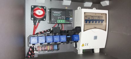

We had no solar charging problem on our trip few days ago and we called the service about it. After a while the service called back and asked to check the ST1 fuse. Pulled it out and it was ok, but this "power reboot" made the solar charging work again. Adding picture for the fuse. Its under the bed in the back under the solar charge controller.
Hi, many thanks for your advice on pulling out the ST1 fuse. Do you perform this, with the red power button in the off position? Regards,
I have posted a photo of my solar electrics, in the hope that the fault maybe identified. There is just one green light illuminated and sometimes this flashes green. Regards,
