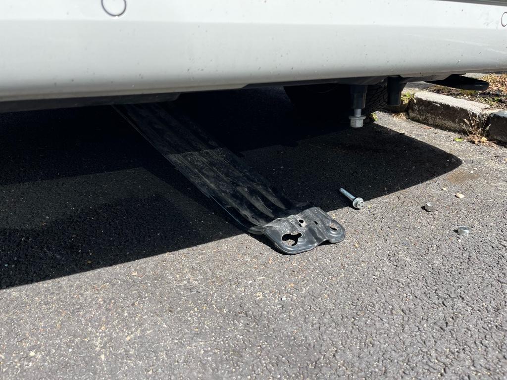

Hi all, early this morning our spare wheel got stolen from under our van. I had only just replaced one of the bolts with a Trilock wheel lock! I didn’t fancy the size and aesthetics (and the weight?) of the big red thing some here seem to be using.
I purchased the Trilock from the club shop a while ago, and will be reviewing it appropriately..!
What is the consensus these days on how to best protect the spare?
I never used the spare so I don’t even know what it looks like. Any ideas on what a replacement would be? Same size of current wheel/tire?

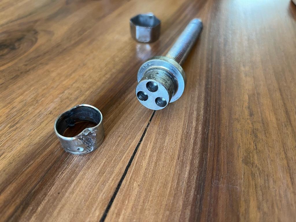

Thanks all for your replies and commiserations.
Looking at it again, the thieving shits seem to have just popped the spinning ring off the security bolt and taken a good grip wrench to it.
Also, they weren’t loud about the van was right outside our bedroom!
I do NOT recommend the Trilock from the club shop. Not sure I want to buy a big red thing that starts flaking after a year, and perhaps we don’t even need a spare. Grumble.
A 150N/mm torque and even a good wrench would have been ineffective.... reminds me I've snapped another 1/2in extension on mine recently using a 600mm powerbar to remove wheels
Hammerite red, job done.
The big red thing prevents the mole grip method. If they are determined they will get anything off but it might make them walk to the next transporter instead. Those gunge kits are useless. Much prefer a spare. Even if the AA have to change it you are back to full speed.
