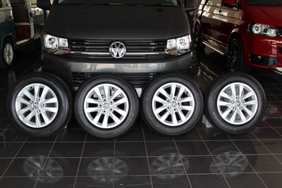

If 16" you could buy a new set and use one of your existing ones as a spare with 3 more for the future.
