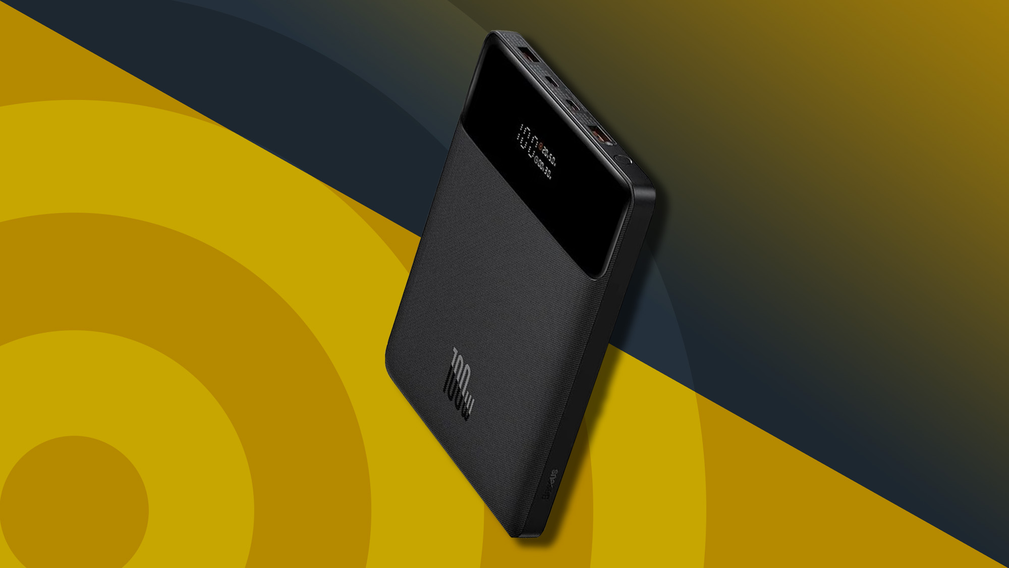

thanks for the reply, does that mean it will charge? albeit at a slower rate?
would this work and any ideas of the pros and cons
https://www.amazon.co.uk/dp/B003FOOY32/?tag=unique09f-21
also any of these:
sorry for all the questions But I plan to Digitally work off grid
Worth considering Legins advice as the pure sine wave inverter plus your laptop OEM charger is less risky for your laptop electronics and you get the added advantage that availability of mains voltage allows many alternative appliances (provide they will not exceed the rating for the inverters power output) to be used with their original power supply.
Having said that the smart Power supply you linked to will do the job and the power bank gives you a reserve option (provided you keep it plugged in when driving to keep it topped up) rather than finding that the single leisure battery in a beach is struggling to keep up with all the demands.
Worst case is that your intended usage may mean that the Leisure battery needs uprated to a higher capacity or a solar panel on roof ( typically 100watt power input to your battery which would offset the laptop use in reasonable daylight ) or to the double leisure setup in the Ocean.
I am sure there are other “off grid” workers who can help with what they power in their vehicle and typical off grid usage before their leisure battery “runs out of steam”
