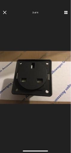

Just wanted to share a little project. So it bugged me that the van had a Schuko (euro) type socket. I decided to change it it out for a UK 3 pin one.
Managed to determine the plug was CBE C-line type. I purchased a 3 pin one.
Changed them out and now we have a UK socket.
Well pleased! (Below is the Schuko)

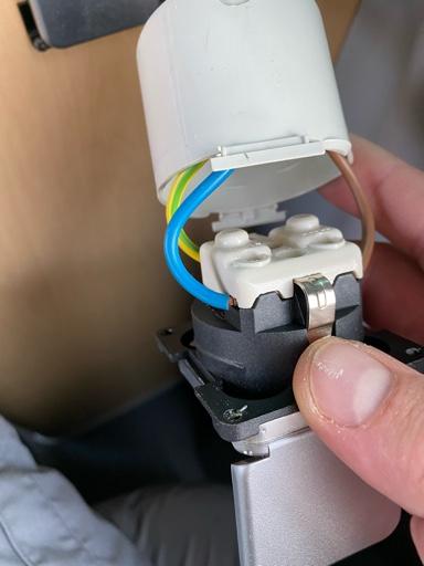

This might seem a daft question but I have my reasons. What type of screws held the socket to the kitchen unit? I want to remove mine (t6.1) to get access to the wiring in order to run another cable to a second mains socket I want to add near the fridge. Had a concern that it might have nuts behind the panel which would drop off!
Nice work.
Thanks. I have a T5 but I can’t imagine much has changed. They were short self tappers straight in to the kitchen unit. They have a T10 head. Just don’t over tightened them.
I think your socket will be the Berker type. You will soon tell when you take the cover off.
Good luck.
