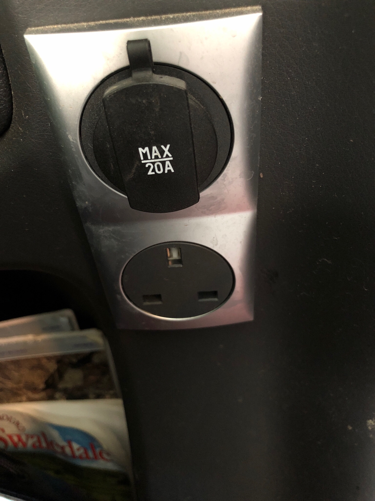

Hi all
I’m away in Scotland at the moment and didn’t bring my manual.
Struggling to get the electrics to work on hook up. The standard plug doesn’t have power and the cool box in the boot isn’t working either.
Other campers are having no issues so not an issue with campsite power or my cable from van to power point.
Is there a reset button somewhere? I can find info re the Ocean but not my beach.
Any help appreciated. Food about to spoil.
The 20a socket above the 240v one works fine so I’m confused as to what the problem is
Thanks all
Ade

I think you are now confusing the 12v system with the 240v mains system.
You said the 12v socket(marked 20a) works and you can recharge the leisure battery by running the engine and the fridge is working on this socket whilst the battery has charge? Yes? In which case all the fuses must be okay.
It is therefore just the 240V mains side that is not, yes?
Can you see the back of the mains socket and is the cable in there all connected and not got a loose connection?

Yes, you are probably right. It’s the 240v section that’s not working.
It’s tough to see anything where the cables go. Nothing has moved as it was working yesterday and has worked in the past. Does the 240v supply have a fuse other than the breaker switch?
I’m guessing something must switch the power from battery to mains? Maybe that’s the issue?
Thanks
The 3 pin mains socket has no connection to the battery, its not an inverter supply it is only supplied by the hookup through the safety breaker.

Okay, lets rewind:
Just re read your original post: when you say mains socket, do you mean the standard square 3 pin socket like we have in the house?
Or, do you mean the inverter socket with the lift up flap in the B pillar? (Assuming you can have this as an option on the Beach)

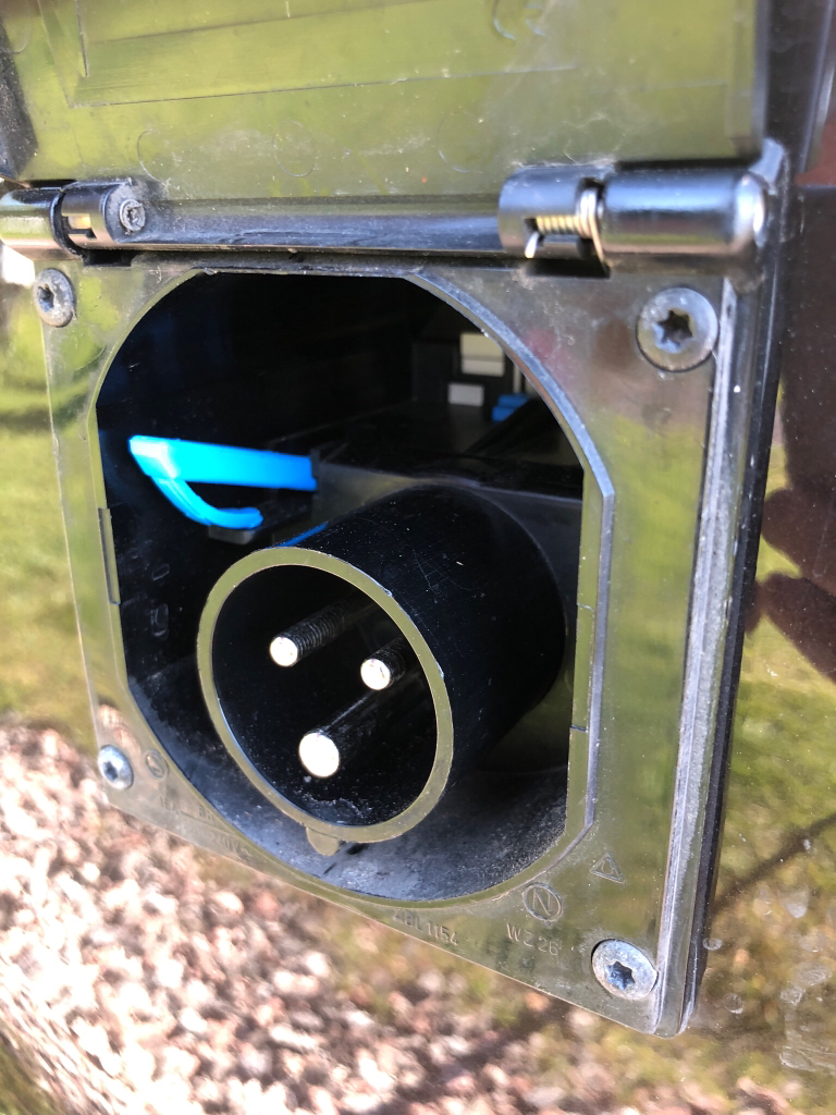

I am beginning to think there is a loose connection between your external plug and the RCBO (breaker for the purposes of this thread) because test button does not trip the breaker, it could be the breaker itself but less likely as not heard of many failures.
I would just try anouther hookup lead into your van to be sure, even though you man tested your lead with a lamp.
If it were working you would have power to the socket and the battery charger and you wouldn’t need to run the engine to charge.

Thanks - yes - I’ve tried another cable from a nearby camper and theirs doesn’t work either.
The standard household style plug doesn’t work at all and the 20A one now only works when the engine starts as the leisure battery is flat.
The trip button doesn’t do anything on the mains breaker (in the space near the jack), so doesn’t sound like there’s any power getting in at all, so likely to be a faulty connection or breaker?
I still don’t understand how the power flips from the battery to the mains? Does the mains simply charge the battery? Is the 80A fuse under the passenger seat only apply to battery power? If so, the fault must be at the mains end.

Looks like I can get better access to the wiring by taking the cover off this.
Will have a look when Home as I don’t have the right tool here
