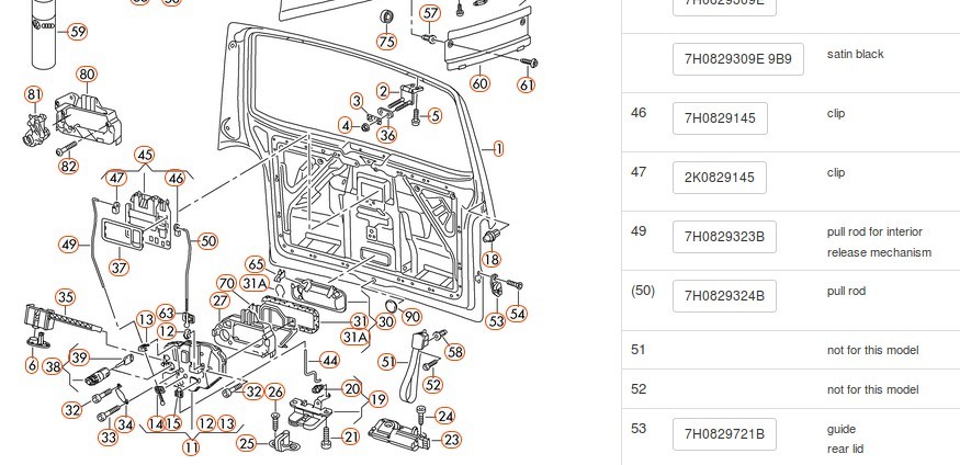

The strap for pulling the tailgate down has just broken.

Well, I am quite surprised nobody else uses the tailgate strap, but my wife absolutely needs it, so I decided to get a new one.
All the on-line catalogs I tried do show the strap but say it is not for the California & don't give the part number!
Surprisingly, my VW dealer got the same answer from his on-line catalog too!
But he managed to find what seemed to be the same item elsewhere & ordered that for me.
The catalog said no stock at VW either...
Finally, the part arrived today & is exactly the right one.
Part number 7H5829621B 9B9 if anybody ever needs one...
Now I have a new one, I have dismantled the old one & am fitting it with a stronger (webbing) strap, ready for the next incident!
