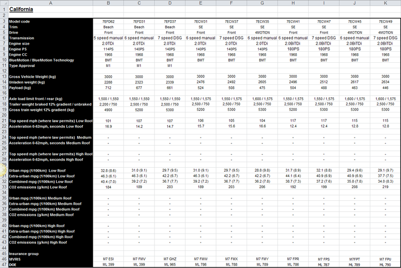

Hi, does anyone know the code for 140hp engine?
Thanks Rippers. That has explained the code in my service book. Cheers :)
