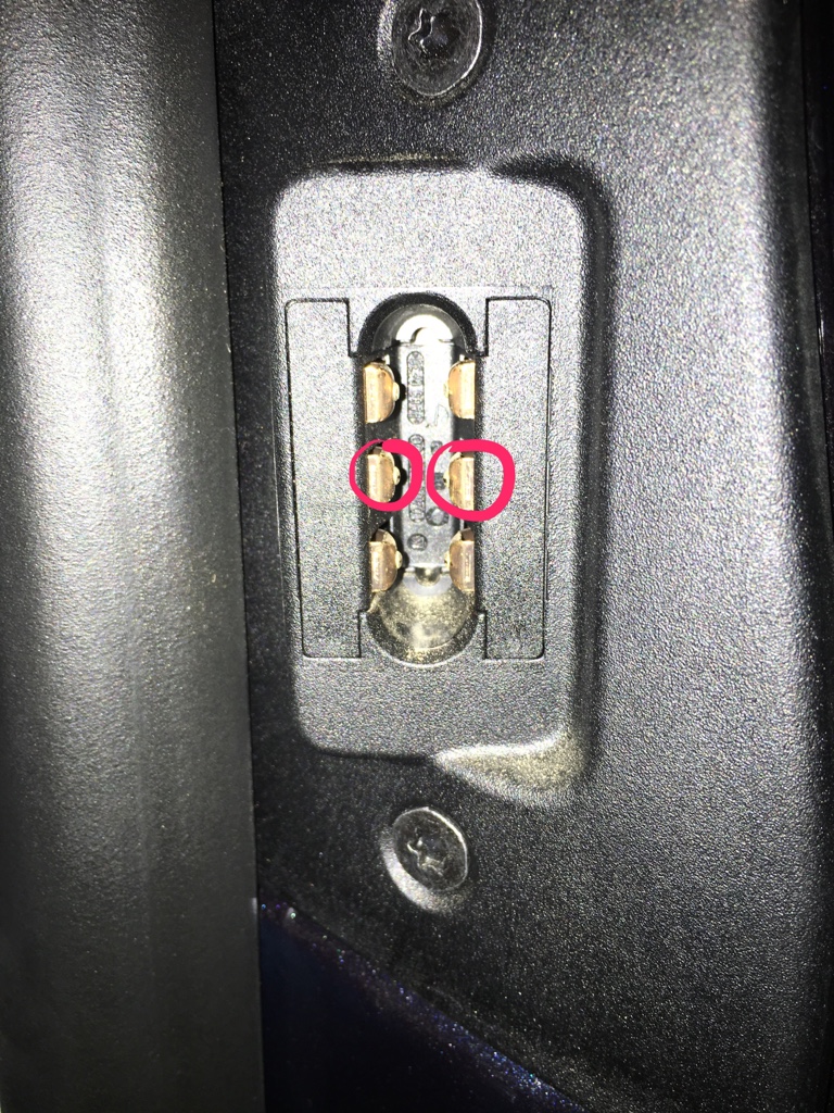

Yes we have problems with our new T6 soft closing side door. There are some other T5 and T6 having the same problem. Had yours at VW and they couldn't find the failure. Workaround: short cut the contacts 3 and 4 with your key and you will hear the motor of the soft close. After that the soft close works normal. If you don't hear the motor when opening the door then it would not work by closing. So you can short cut before closing the door.
Hi. I have the same problem on my 16 T6. Shorting the connector works, but I want a permanent fix.
