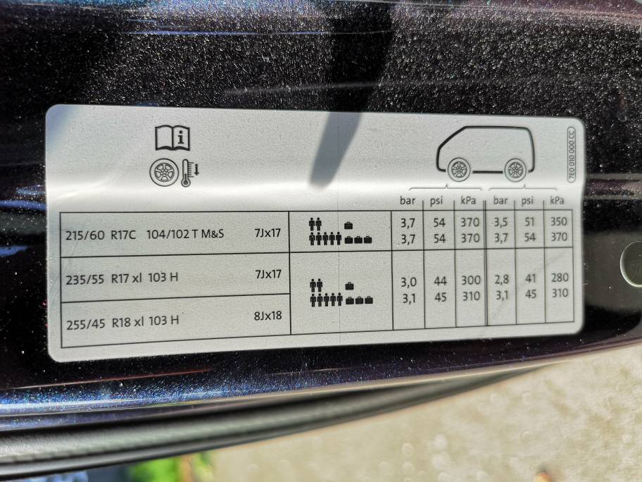

I have a 2019, Cali Ocean with;
DSG, 4Motion, fully laden (including 2 heavy full size electric bikes). What psi tyre pressure do people use who have similar set-ups
Tyre Make: Bridgestone
Rear: 235/55 R17 103v
Front: 235/55 R17 103v

Do you have a sticker on the drivers door frame, should give you the pressures for the various tyre sizes and leadings? I’ve just had new tyres and set the pressures to 44 psi, 235/55 R17.
T6 Ocean, 4 motion (not DSG though)

I recently checked my tyres on my 150 dog Ocean and found that they were over inflated by nearly 10psi. Each one was deflated to the correct pressure as shown on the drivers door label. The TPM was also re calibrated to prevent alarms.
The ride is noticeably softer now, but why would the main dealer over inflate them so much?

Same here…. checked the pressure few days after delivery, and were all set at 3,6 bar. I was even 'afraid' to drop them to the recommended values.

Probably because they are used to commercial van servicing and 'always' use that pressure without checking what the correct pressure is for that vehicle and tyres fitted.
Very annoying when you always set/check them to what you require. Always check them after Dealer visits now, usually set wrong.
Not much in it, fronts 3.0 to 3.1 and rear 2.8 to 3.1 a fitter suggested us trying for rears an in between pressure ?
