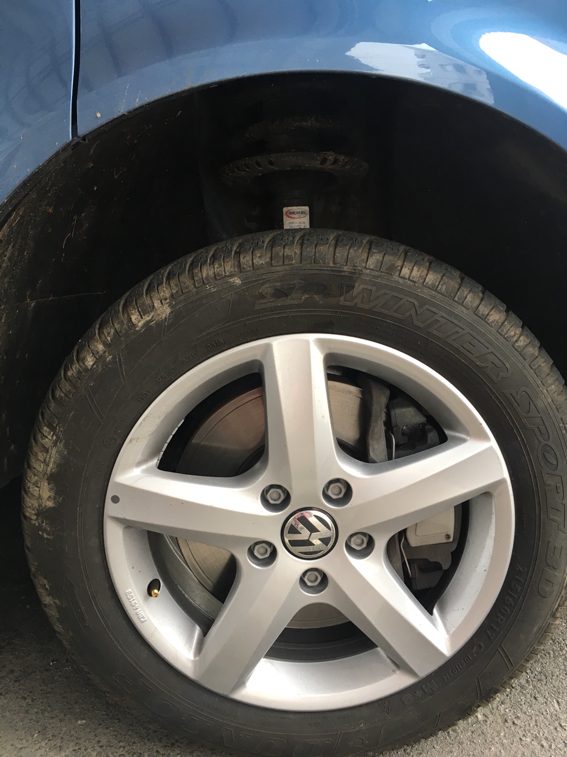

I’ve got Dunlop winter sport on steels for Alps which you can use chains with and Goodyear Vector 4 seasons for alloys in summer / English winter which you can’t use chains with .Both excellent . Interestingly I get more mpg ( 2 or 3 ) with Dunlop on narrower wheels .

Definitely go for 215 / 60 R17. They are compatible with snow chains. Factory fitted. Dunlop winter sport.
