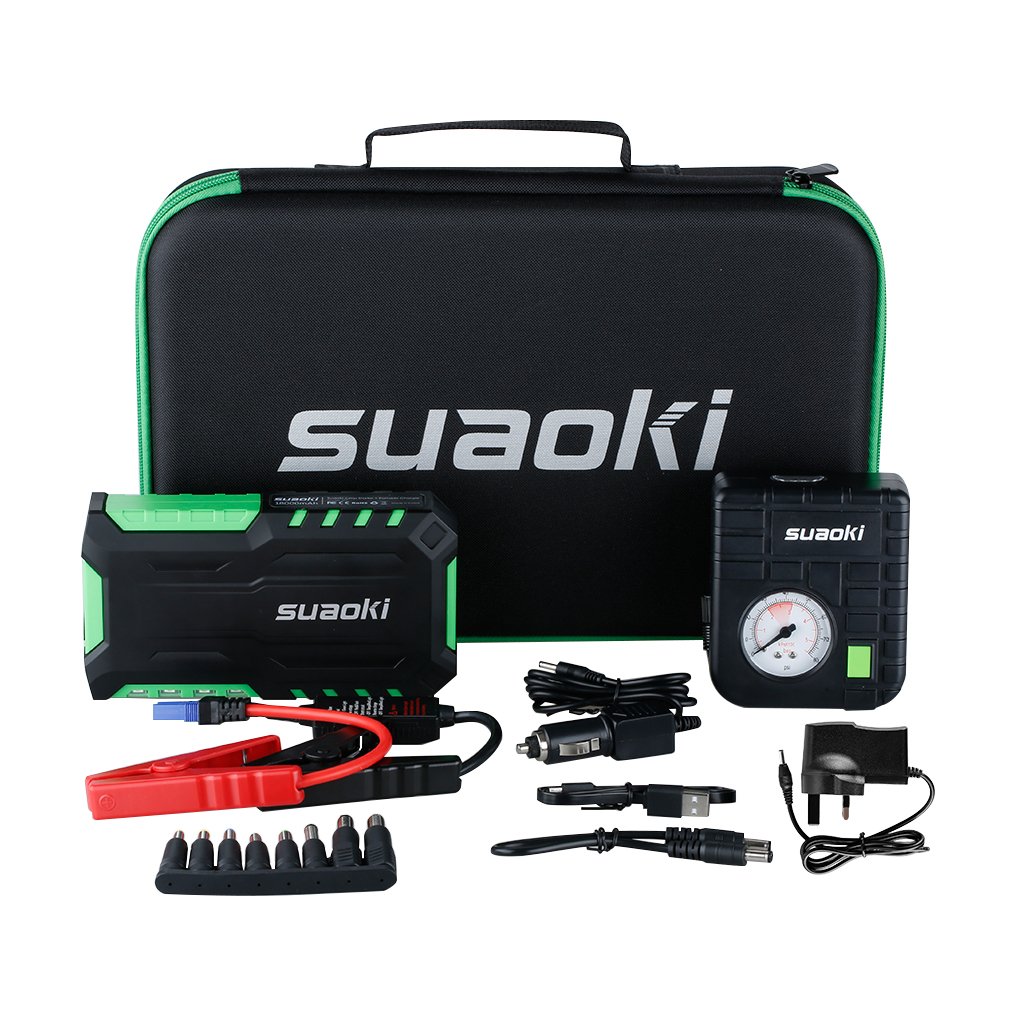

Don't be too sure! I have a 2007 T5 and left the ignition on for a while after bringing the roof down, it flattened the battery. Good thing I was at a Cali meet and T6 CFO (Mike) was there and only too willing to test a little device he had bought for just such an eventuality.
It was wonderful so I have one now!
https://www.amazon.co.uk/Suaoki-Starter-Battery-18000mAh-Compressor/dp/B017IJ9IYE/ref=br_lf_m_zw6djypn9j5493z_ttl?_encoding=UTF8&s=automotive

I bought a very similar jump starter to the one you've bought last year - I got to use it in anger for the first time the other day to start the mother in law's camper van and it worked a treat!

They´re a great thing to have. I got mine after a tip on this forum.GB40-Portable-Lithium-Battery-Car-Jump-Starter-Booster-Pack-For-Jump-Starting-PT01.jpg

The one I have includes a compressor for inflating tyres as well. I hope never to use any of it for anything except possibly emergency charging of phone or laptop.
