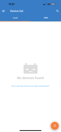

My Victron app has been working fine for months; last night it was working. It’s an MPPT100/20 Bluetooth.
Today, this error message is appearing.
Any ideas how to trouble shoot? It has only ever been connected to one device.
The LEDs on the charge controller are lit, so it seems it’s working?
Low battery on phone turned off BT ?
I'd disconnect the solar fuses and the input / output wires and then reconnect to see if that fixes it.
Otherwise, delete the victron controller from your phone's Bluetooth devices and then see if you can readd it.
I deleted the app & reinstalled. No joy
It never hurts to reinstall an app when things are playing up, but I'd still specifically remove the Victron device (SmartSolar + string of a numbers) from your phone's Bluetooth connections menu. On an iPhone it's under Settings > Bluetooth > i > Forget this device
Then pull the fuses and MPPT connections and reconnect.
