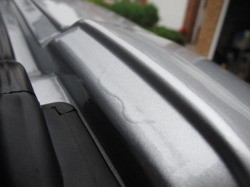

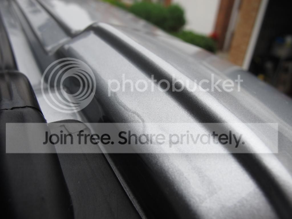

Hi there Snowy55,
Thanks for images and angle on repair/claim. Our paint runs were very similar to yours….probably original VW, although paint depths would suggest otherwise. Good point about additional paint thickness still failing to protect.
