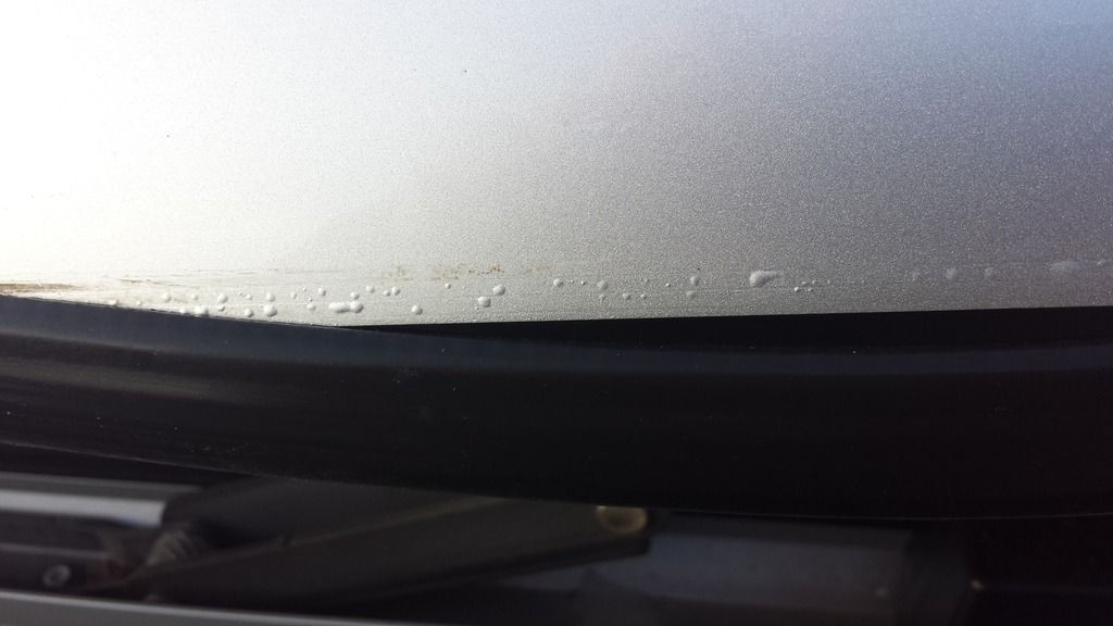

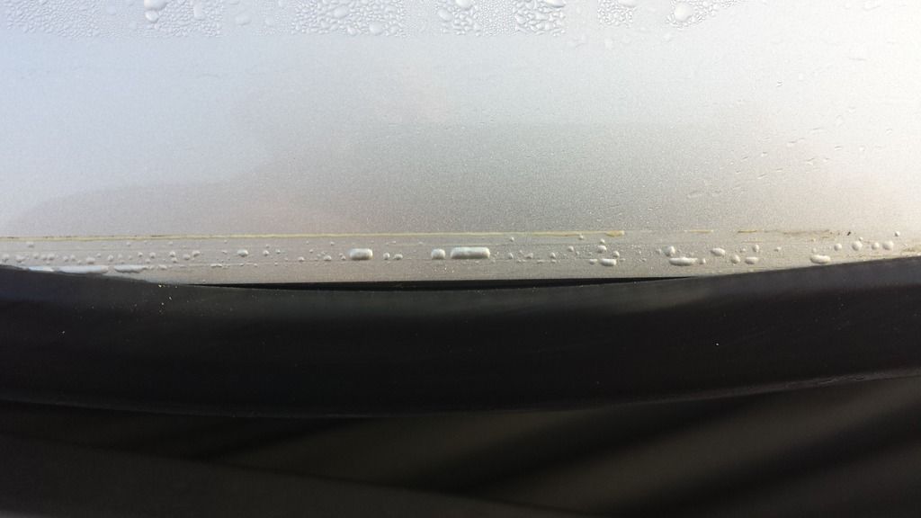

We had the raising section of the roof repainted about this time last year (2015) due to the paint bubbling underneath the seal so I thought I would have a look and see what was happening.
Slide off 2 sections of the rubber seal, 1 each side, and this is what I found,
This is what it looked like in 2014,
Oh dear, very disappointed looks like the "new" painting procedure doesn't work.

That's doesn't look too encouraging - hopefully the repair is within warranty and you can get it sorted again, but what a pain to sort it.
