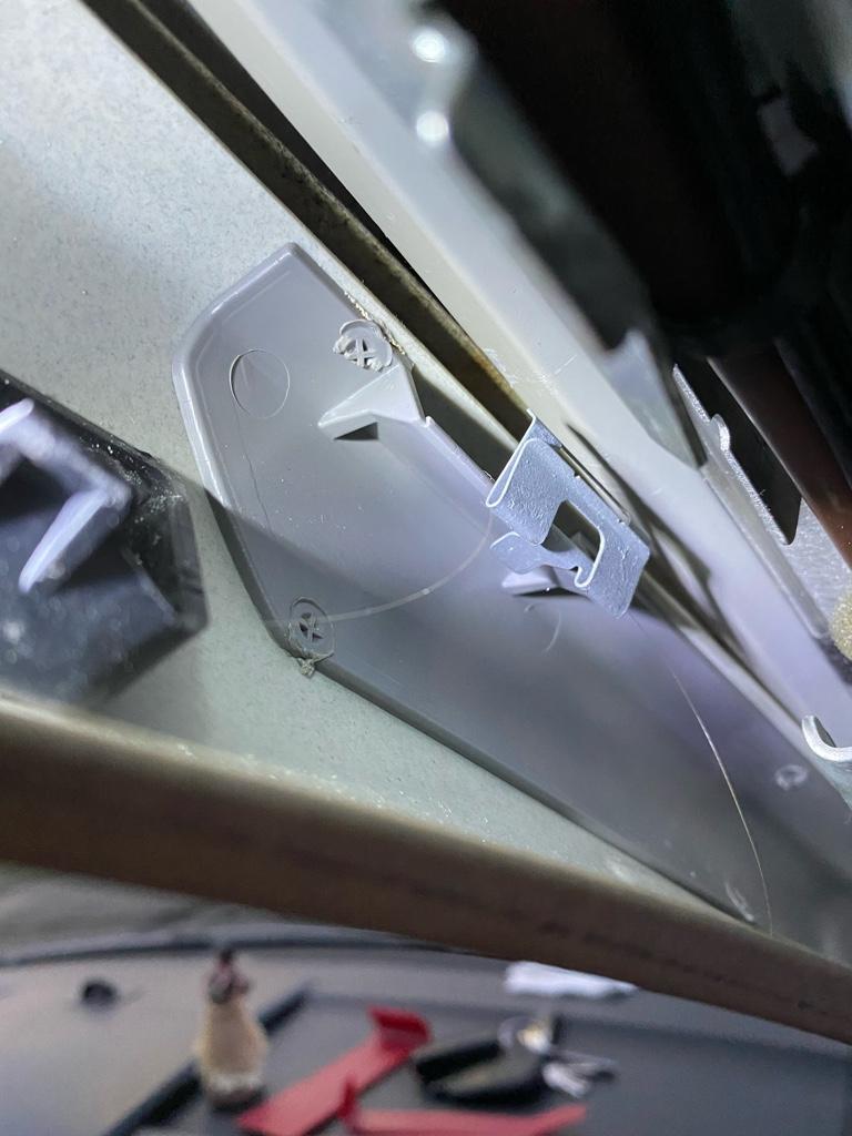

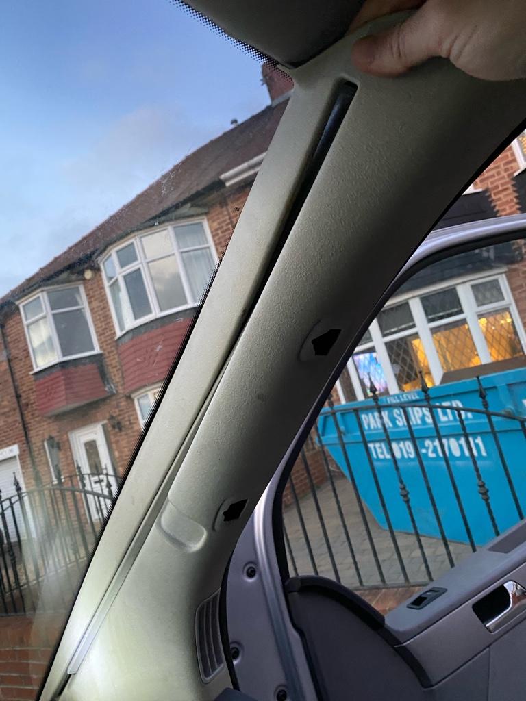

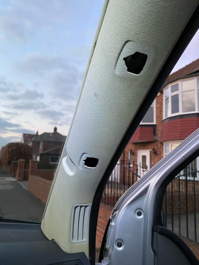

I have managed to pry the top of the a pillar trim off, but despite searching the forums which lead to YouTube links of taking the trim with no roller blind off and diagrams with share parts but not any narrative I’m stuck and I cannot get this trim off
I can see the little brown tube but I think I need to fully get the trim off before I pour more water through to observe whether the tube is leaky or the seal. I did see the diagram of the tube that drains the water and this reinforces my belief that a correctly working drain tube should certainly have nothing to do with body panels!

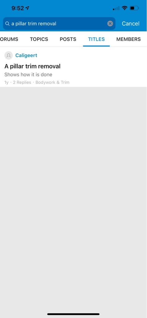

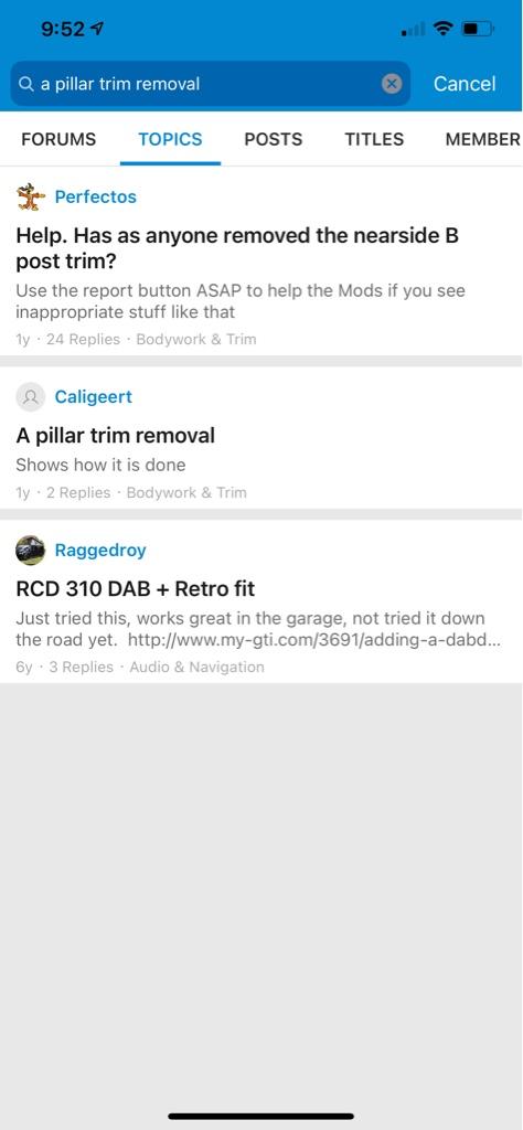

I feel like I’m going crazy here. I am a VIP member I think. Can’t see Loz’s post even searching the exact title. Maybe Tapatalk app is not compatible with parts of this forum.
Looks like the app doesn’t work because the how-to guides for VIPs are in a different section which technically isn’t the forums.
There is an A trim pillar removal guide in the resource section, if you are a VIP member you can access the resources

Thanks, I've ordered one of these so I can hopefully peer into the A-pillar when I do the water test again! fun
To see the whole system you have to drop the cab roof liner down. You can then see the tube where it comes from the plastic 90 degree bend which is a few inches in from the drain hole in the roof channel. It's possible that the bend has got pushed off the tube from the drain hole or the downward tube has come off the bend. Absolutely stupid design asking for problems. Who the hell decides to drain the roof through the insde of the vehicle. VW.
To remove the pillar, one of the procedures is to first remove
the speaker cover, its also connected to the sun visor at the top,
in-between it has the plastic pull off clips. Hard to get off.
When i partly removed my headliner i could see the joint where the
drain pipe connects. Its the headliner that you need to attack, removing
the A pillock will only show you the pipe, like this, its a straight downhill
run.

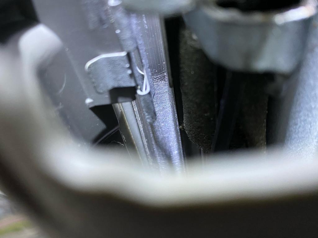

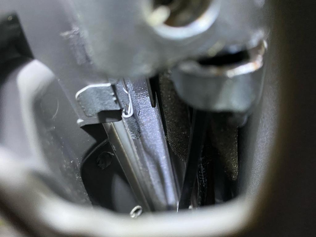

so I popped off the cover and carefully inspected where the drain hole is and if I move the cluster of wires a little bit with my hand to nudge the rubber grommet it’s obvious water is getting sucked in and out on the other side from the drain hole, and presumably this should be sealed well enough for that not to happen...
If you clean and dry around the rubber seal you could put some black Sikaflex 512 around the bottom and sides of the seal as long as you keep the drain hole open but Sikaflex can be messy and difficult to remove so perhaps just some external silicone or you could try Captain Tolley’s Creeping Crack Cure (leak/crack sealer)...

It would appear you’ve found your issue,
if your going to seal that up, I would get a wet vac and suck out as much of the moisture as possible, give the whole roof channel area a really good clean, allow it to dry fully ( possibly assist with a hair dryer) get a cotton bud and clean under that seal, then mask up all the surfaces and pipes etc to keep the sealant where it should be and off the other surfaces.
Are you sure the water that is being sucked in and out is not just residue? Before sealing the grommet/seal I would make sure that the leak isn't in the pipe and its joint by pushing water down it ( I use a syringe with a bit of tubing pushed into the drain hole. Hopefully you have found the problem but it would be a shame to seal it all up then find its not the grommet!
