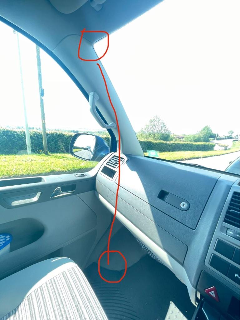

Time to fess up an joint the party: I've been chasing the same leak since February.
Like others here I've checked and confirmed it's not a leaking drain pipe, have bought a borescope, have tried replacing cracked sikaflex, got very close to replacing the windscreen (but fortunately realised it was coming from between the layers of body panels, not the windscreen seal, before I actually got it done) and yet it keeps coming back.
Like @ArunAlec and @Lambeth Cali it doesn't seem to leak with the roof up, and with roof closed it is getting in and pooling somewhere intially, then pouring out at the top of the A-pillar when I move the van (usually when van parked nose-down, then comes in as I move off the drive onto flatter tarmac). I did get to the bottom of that bit with the help of the borescope - when I move the van it pours in through this hole (photo from video):
...then down and out between the body panel sheets at the top of the A-pillar (as described here). The hole you're looking at is above and a couple of inches outboard of the passenger sun visor attachment point (you can just see it by eye with the sun visor removed and your head in the right place). I think it's this hole here:

For me it was manifesting in the passenger footwell, with a wet carpet. It was only once I removed the A-pillar trim I could see it was coming in at the top corner of the windscreen then flowing down behind the A-pillar trim and out at the bottom, into the footwell. Like others I initially thought it might have been the windscreen seal, but it was actually coming out from between two folds of metal that make up the roof structure, right at the top corner of the window.
Without the A-pillar trim in place it just rains down like a waterfall from that point into the cab, all over the dash and door trim, and usually all over the unsuspecting passenger…!
