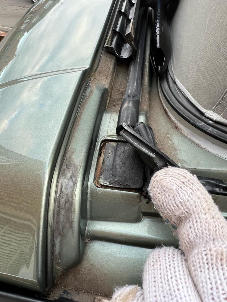

Whilst sealing the grommets I discovered that the rubber sealing strip across the front of the roof panel has a gap each end which I assume is there to stop a build up of water. View attachment 80231
Yes, it's good to clean that gap under the rubber seal whenever you clean the Cali. The gap allows excess water in front of the seal to drain through the gap and then down into the drain hole channel and out.

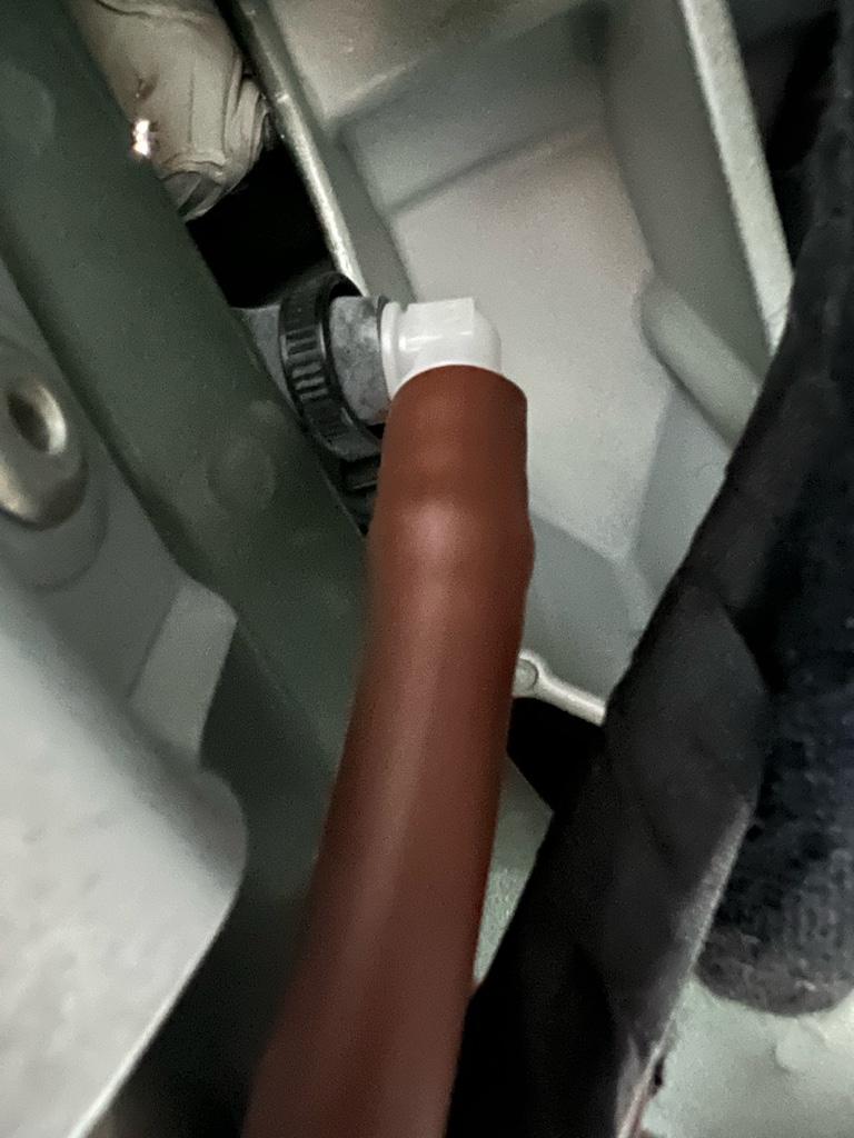

I recently found water was running down the inside of the A pillar trim onto the carpet in the footwell adjacent to the door. After days of investigation using a borescope and the usual checks of the roof drains, screen etc I have hopefully found that it was the roof drain grommet as @NRDSRFR post above. I've cleaned it and sealed with an Auto sealant from Euro Car Parts and so far so good.
Whilst investigating I discovered that the water somehow was tracking down between two layers of body panel at the top of the A pillar. Also unless both grommets left and right were leaking, then water was flowing across the panel above the screen as I was getting the same leak on both A pillars. I also found that the water must have been pooling as if I moved the van forward and applied the brakes water would flow as it "surged" forward.
The roof lining was not getting wet and water was not running on the outside of the brown drain only as shown.
Whilst sealing the grommets I discovered that the rubber sealing strip across the front of the roof panel has a gap each end which I assume is there to stop a build up of water. View attachment 80232View attachment 80231
Where exactly is that on picture no1? I can see the brown drain pipe but where is the picture taken? I have this same problem and tried to find the leak by pouring tinted water with the drain hole plugged. The water disappeared but did not show up inside the cabin. At least the water leaks only on left side where the hole was plugged after a rainy trip. Still searching.
The top pic is the top corner of the windscreen viewed from inside the van, having removed the A pillar trim. The coloured towel is on the outside (put there reduce glare for photo).

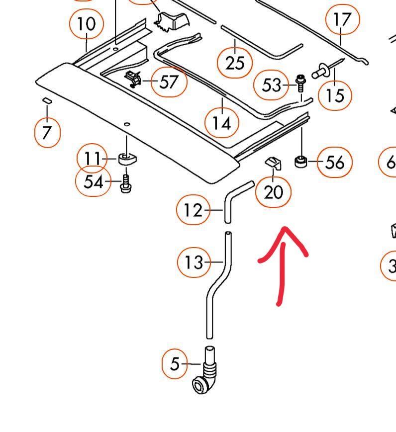

Hi all, is there a way to replace this rubber grommet? What’s the part number? Are there any instructions how to do it?

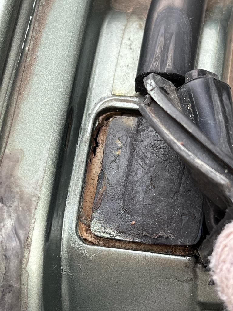

This is what I found on my Cali’s roof after some investigation:

The part 20 is ...
7E7875211C LEFT
7E7875212C RIGHT
you should be able to order direct from VW or website below but I don't know how you'd change it. If you can't replace it you could use a black Sika compound to seal the leak area and refit the grommet you removed.

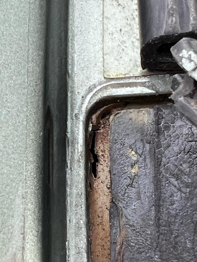

That is really descriptive pictures of how that construction looks like. Do I see holes of corrosion?
Found it here as well, part 20,
7E7875211C LEFT
7E7875212C RIGHT
£7.10 on lllparts.co.uk ...
I can order the product number you’ve shared. However, with the C at the end - no products were found in this category. I can see it in the table though, a bit confused tbh .
I can't find part number 7E7875211C, very confused

Yes, you are right. The hole is under the grommet, which looks like another rubber with sealant (grey colour), at least from the inside, see my previous pictures. Not sure what will be the best solution here to fix it.
Not sure about the corrosion, it’s soft. Looks like a plug or something with a lot of grey sealant/compound from the inside.

The grommet is in place now,, yes, but the hole under it still exists, which will leak again with a next heavy rain I guess. We’ll see in the morning :))
I‘m a little puzzled! The grommet in your photo appears to either be in 2 parts or has split into 2, one still in situ and the you have lifted. The parts diagram only appears to show a single item “20”.

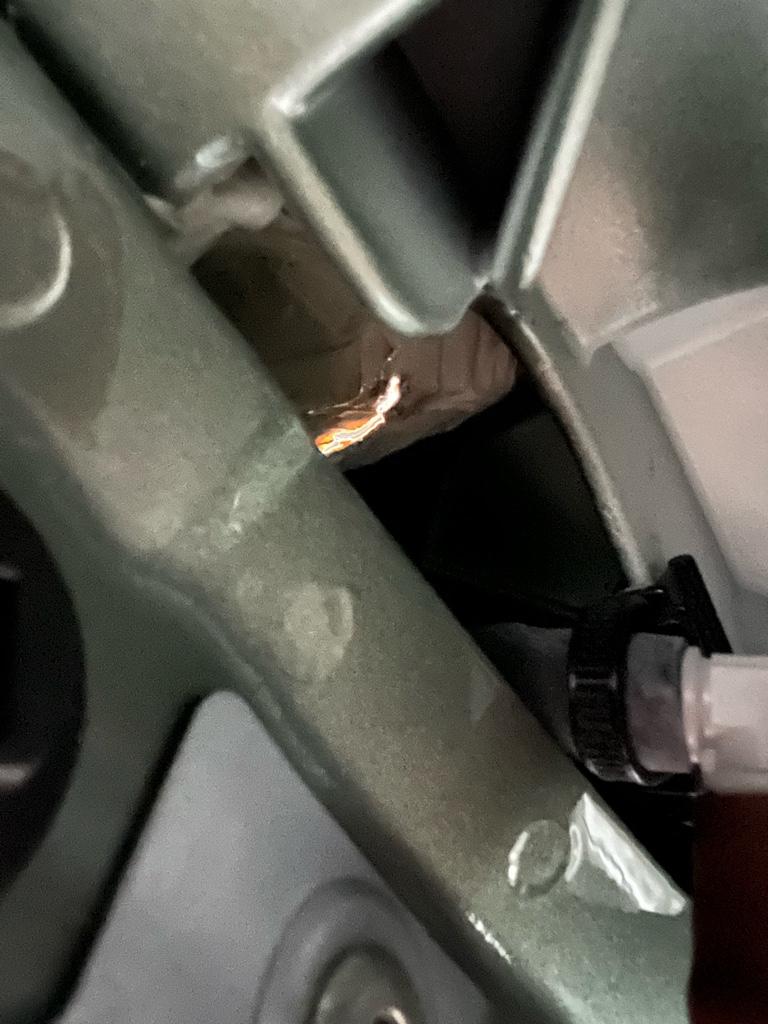

Initially, water was appearing in the drivers footwell. I pulled apart the trim in the lower dashboard and traced it up to the A-pillar. So I removed the trim on the pillar and traced it up to the top corner of the windscreen. Thinking I had found it I had the windscreen removed and the seal replaced; but this wasn’t the problem. As mentioned earlier in this thread the water was finding it’s way through a tiny overlapping bit of metal above the windscreen. So I pulled the headlining back and found the drain pipe, which is connected properly and draining properly. I don’t think the drain is leaking, although the leak is somewhere nearby. The rubber grommet in the roof where the electrics disappear into seems fine. There is a small amount of corrosion but nothing noteworthy. If I open the roof and pour water into the drain it works properly. If I block the drain the water doesn’t go anywhere. I’m struggling to trace it any further because of access to that piece of the roof.
