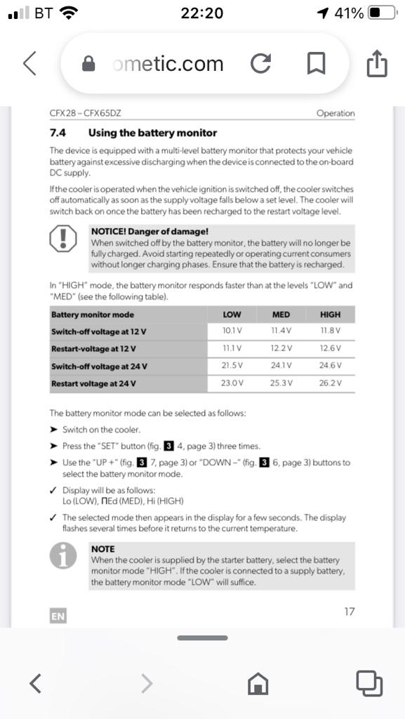

I am use Dometic cfx55
The Dometic CFX range have a low voltage cutout. When the voltage drops below a pre-determined level the fridge stops working until the voltage rises. This is to protect the *starter* battery on most vehicles, but it also has a setting to protect damage to auxiliary batteries.
The three settings are displayed as hI, md, lo (high, medium and low).
It is safe to set the fridge to lo. It will turn off at 10.1 volts and restart at 11.1 volts.
You will also lose about 1 volt between the battery and fridge due to the poor cigarette lighter connection. I have already described how you could overcome this, but if you are keeping your fridge in the boot and you have twin sliding doors, running the cable from battery to boot might be tricky. Keeping the fridge behind the front passenger seat would be easier.
