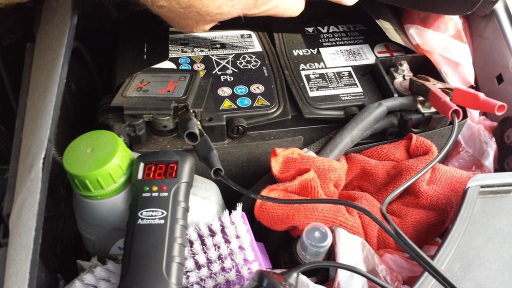

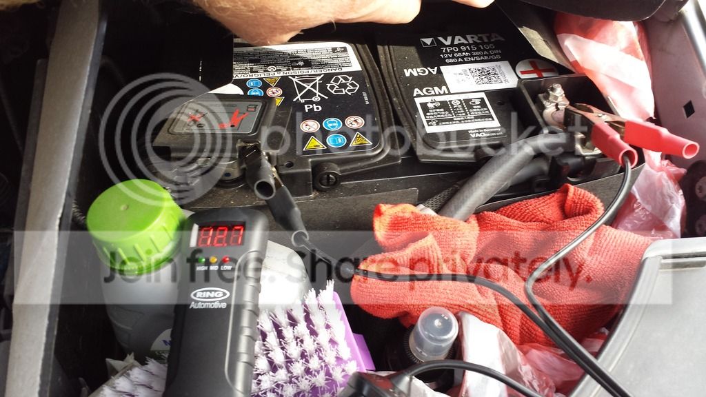

Just tried it at home with the volt meter connected directly to the starter battery. Turned on the ignition waited a few seconds for it to stabilise and no voltage drop at all during the operation of the roof.
But my original question was are they all wired the same?
