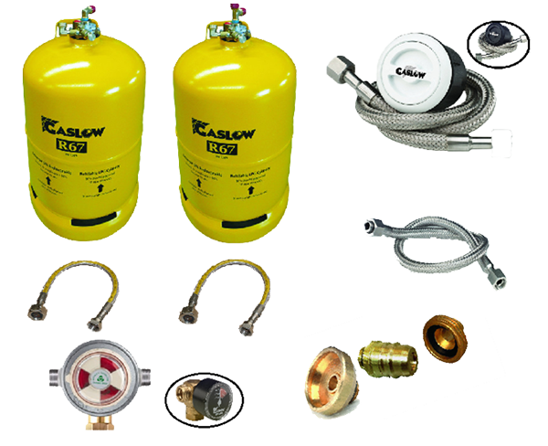

The GC is specked to have x2 11kg propane bottles, I have x2 Gaslow bottles installed and able to refill at a garage that offers propane at about £0.64 a litre. It saves all the lugging around of changing bottles
Also great for if your turning Europe as very easy to fill up.
Check out the link. https://www.gaslowdirect.com/
Let me know if you need any further assistance.

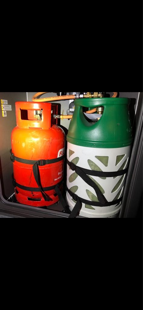

The bp gas light 10kg propane cylinders also fit the cupboard and are much lighter (15kg full) they are sold from Homebase but you need a 27mm clip on adaptor to connect to the Truma pig tails that come with the GC. photo of my cylinders in place below
Are you planning to use it abroad.
Not for the forceable future, just tired the boys cylinder as much lighter

If you are going to be using your van abroad for any serious length of time, i.e. 90-180 days/year x 10-15 years, you should definitely consider refillable bottles as @Breeze1 suggests.
@LindaRothwell has already been ripped off, some of that cost could have gone towards installing refillable.
I had a Gaslow installation, two cylinders with an automatic changeover regulator. It really was fit and forget, all you have to do is fill with lpg wherever you find it (which is quite common in Europe) and you don't have to worry about incompatible cylinders etc.
As you have already found, there are lots of variants in the U.K. then add in France, Spain, Germany, Italy, Greece, Poland, etc., etc.
I have no connection with Gaslow and there are other refillable suppliers, including lightweight bottles.

Thanks for that. We have now contacted Gaslow and we are going to get the full system fitted with the auto regulator. It makes sense. No fuss trying to find the correct bottles. Also will pay for itself in time. Thanks for your help.
Pleased to be of help. Plus, you don't have to lift heavy cylinders around.
