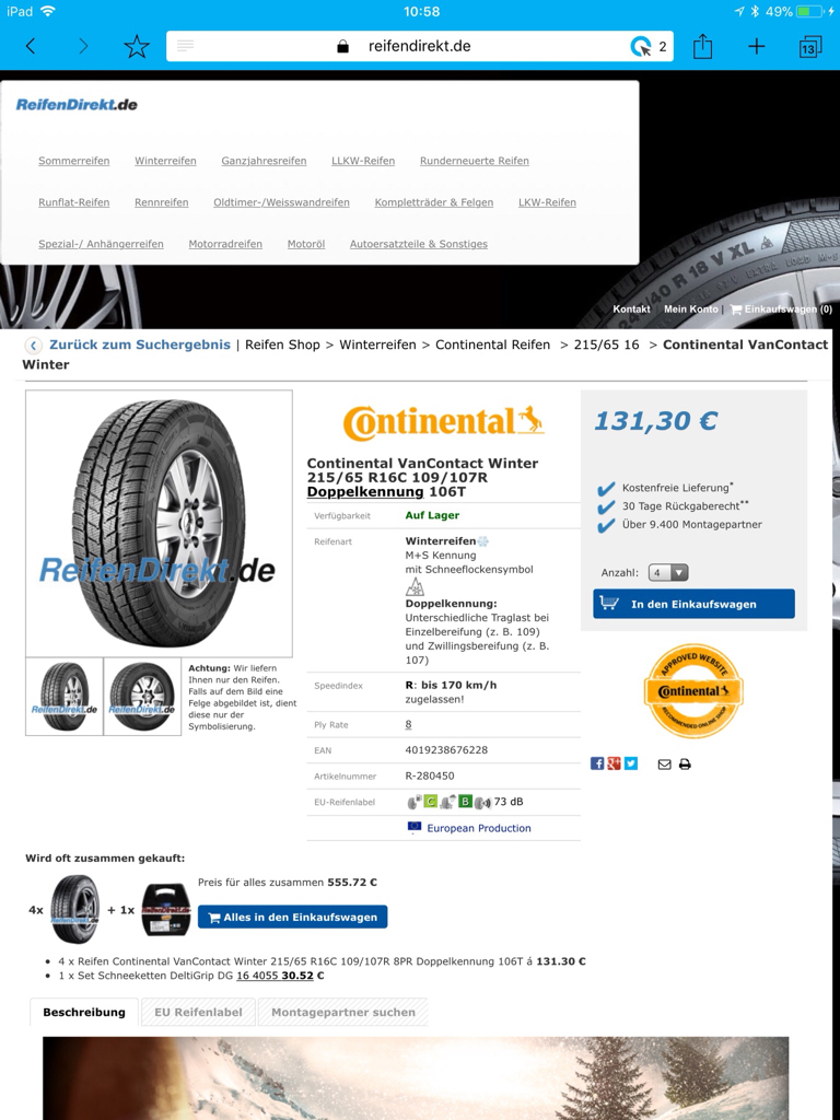

So I have gone to the Swiss equivalent (or so it looks) of mytyres website (www.reifendirekt.ch) and gone to the wheel and tyre selector. Steel wheels with winter tyres, T6 California 2.0 TDI and then I need to choose the type of vehicle. I know I have the 110KW 150PS but is there a difference between 7HC and 7HMA? See screen grab below.
I currently have 215/65 R16 C ContiVanContact 200. It also says 109/107 R 106/104T on the tyre wall which has confused me, there is quite a difference in the tyres available between these load and speed ratings. But I assume so long as I get at least 103 load or higher with R I'll be just fine?

Re the tyre marking 109/107R 106/104T some tyres have dual marking for when they’re doubled up. Would think as a minimum you would need T rated (116mph) tyres, R is only 106 mph rated. Check on the label on (driver side door) B pillar to see what rating VW approve for your T6

„109/107 R“ as it is a tyre for commercial use, if you use them on a double axle there is another weight rating.

Awesome, thank you all. Great advice and good to get the different viewpoints. After sleeping on it I realised that I haven't really seen any alloys that I really like, and I do want to get them sorted for a soon upcoming trip so don't have the time to waste hunting around for the prefect wheel. I'll get the steels and conti's I think. Then I keep it the same size, probably best grip on the road, nice and easy to choose, and stick with what seems to be the more favoured steels in the winter.
As it happens I think it's the same wheel when you choose 7HC or 7HMA, so after all that eh? ha haaa.
