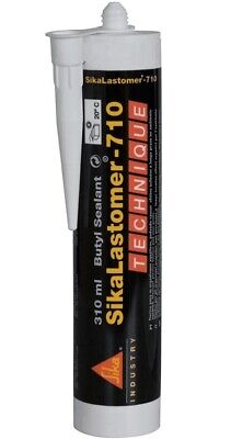

For reference
If anyone wishes to 'seal' the edging to prevent water/moisture or dirt ingress into the area then this Sikaflex should be suitable as it is non setting & Black.
Hi BJG
this method was chosen by Vw as one or the earlier “Fixes“ But it is not now recommend by VW due to their failed attempts with this method in the past to prevent the issue occurring.
the sealant will prevent future inspection, , similarly it will leave a residue of sealant on the panel, which will be hard to remove & give VW a get out of jail free card
Hi BJG
This was a belt & braces suggestion ie tape plus sealant.
sealant is non setting for any future removal, residue could be easily cleaned off with a suitable solution.
