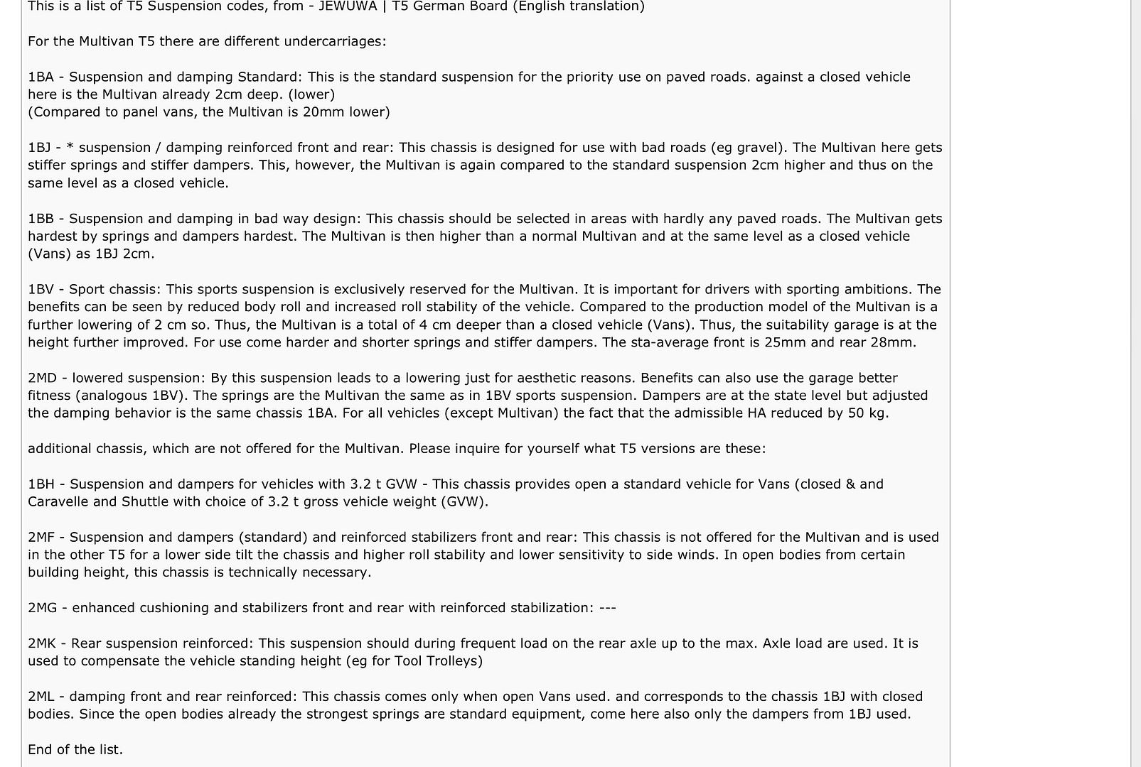

Yes definately worth the relatively small outlay. The rear gives most of the benefit and can fitted very simply on a diy basis should you feel inclined. These are an optional extra on a German bought Cali and come standard on the special edition 60 yr anniversary T5 so no warranty concerns. Here's a quick cut and paste from when I fitted mine a while back...
Regarding the uprated rear ARB I think this is well worth the money for the improvement to the body roll with no detrimental effects to the ride. The VW part no. Is 7E5511407A (was 7H5511407C) and comes with all the required bushes.
It's held on with 4 bolts (2 of them are torx). Just keep the rear axle level when fitting it, very straightforward though I can't speak for the 4wd. (From memory I'm pretty sure they go straight onto the 4motions as well). Recall fitting it without any jacking up hence wheels still on, about 30mins including the first time faff. The diameter of the the arb is upped from 24mm to 28mm and is noticeably heavier. You can get it a little cheaper from TPS if you have one near you else it's your VW dealer at £112.
Attached some old/new comparative pics...

Only other reason you may have the uprated ARBs is because you ordered the sport chassis pack as a factory order, that being 1BV, see below. If you had sportline springs added retrospectively then the ARBs must be part of towbar pack.
Sports chassis pack wasn't an option for the Cali. The Sportline springs where fitted by the dealer before collection
As far as I'm aware the trailer prep factory option does include uprated anti roll bars 2MF and you can feel it!

It was the Tour pack that included the 2MF which was an option I took on my new Cali.
So it probably isn't included with just the towbar prep :sad
Tour pack, SE – includes magnetic flashlight, awning in Black, comfort mattress, heavy-duty stabilisers and towbar preparation
I think they took the packs away from the T6 (at the moment) so if you can select the heavy duty stabilisers I would
