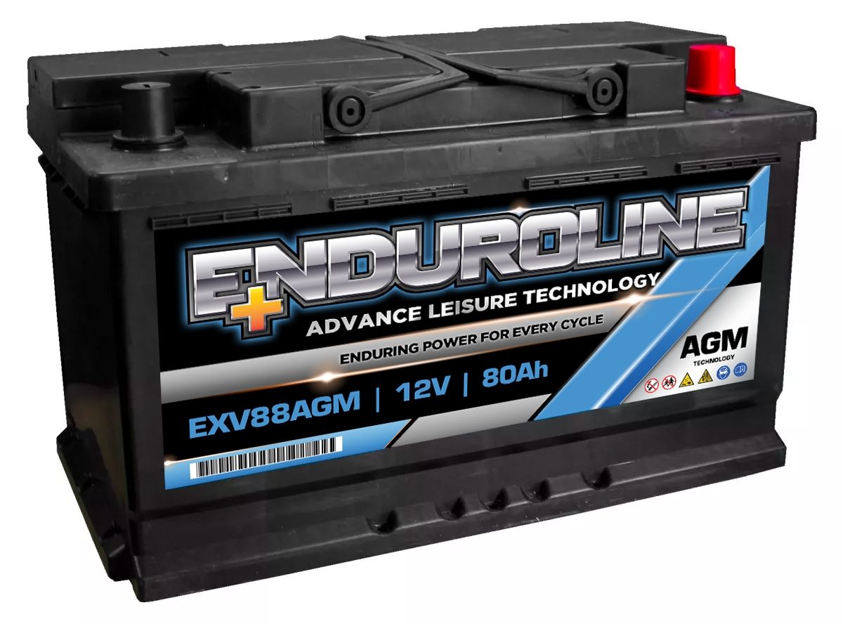

Just before I pull the trigger on a couple of LA80s on ebay… Tayna are out of stock but suggest these as an alternative. Same size and are also a bit cheaper. Any reason this is a bad idea or shall I save a few quid?
thanks!
Personally I would wait and get the LA80's as they are a quality battery. If you call Tayna they'll advise stock date and you can get 5% off with the VWCC discount.
thanks!
A little bit more expensive but in stock.
