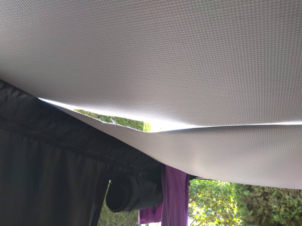

Hi, in hot south France and awning seam has come apart in heat. Winding the thing in now is nigh impossible. On a campsite so could wait until Monday and see if VW Assist could take the whole thing off but they were wanting to take to garage after breakdown maybe bodge it together and transport.. or I could have a go myself after speaking to dealer re warranty. Awkward thing to carry home, any ideas folks?

Has it split all the way across?
Maybe some strong tape and then carefully wind it in with someone
helping it glide along.

Thanks all, it was split half way along its length, glue melted, bit of a 'Blue Peterish' way to hold it together in first place, you'd think it would be one piece. Once it cooled down I managed to get a lattice of gaffer tape to bodge it together just enough to wind it in and seems tight with all the tape sandwiched in there. I'll use some tie wraps I have as well. I'll maybe buy a tarp for the rest of the holidays as shade essential at moment

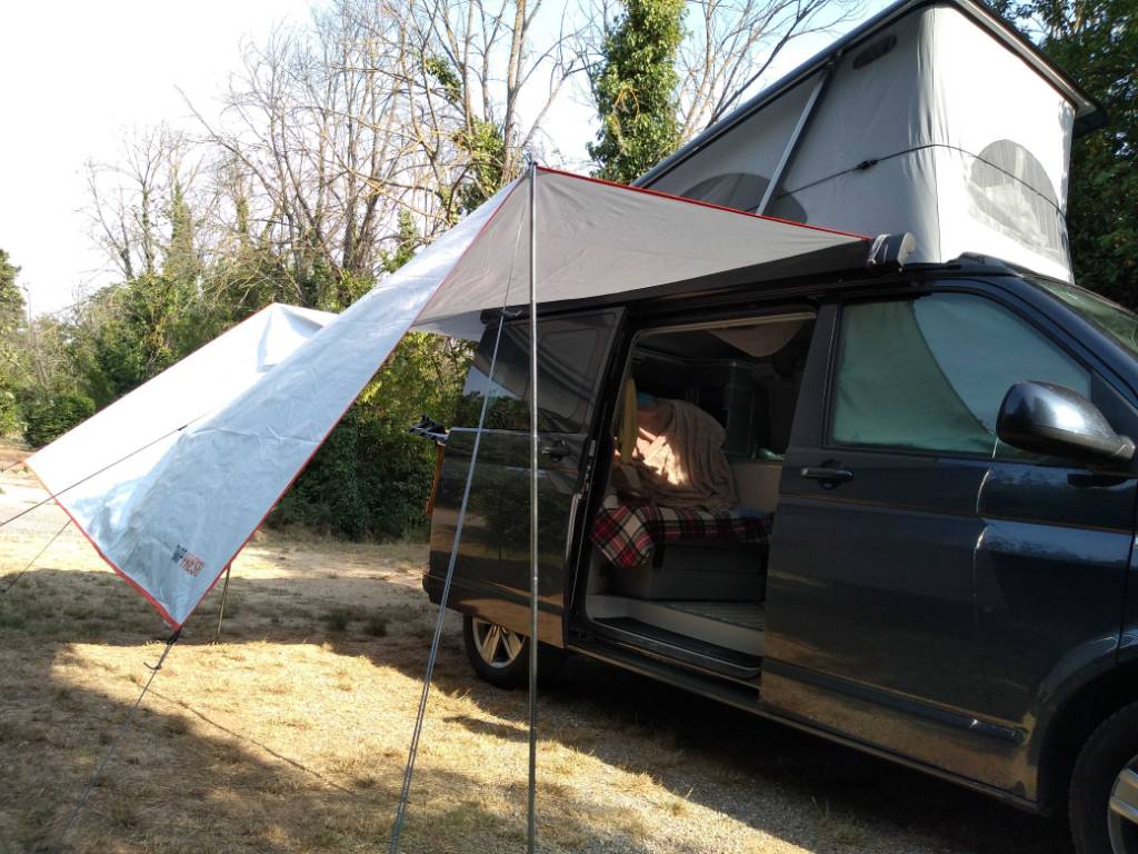

Decathlon to rescue for 25 euros , although somehow I managed to channel all the sun under it
