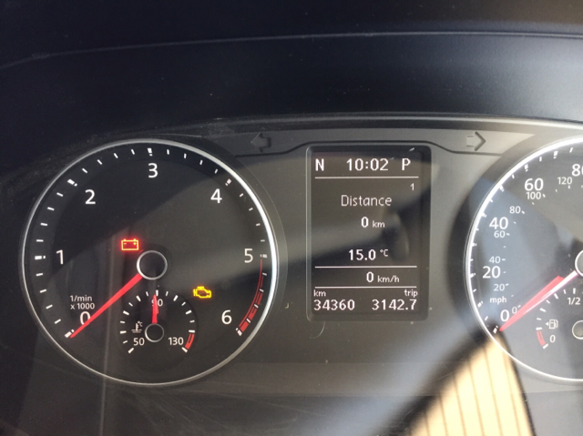

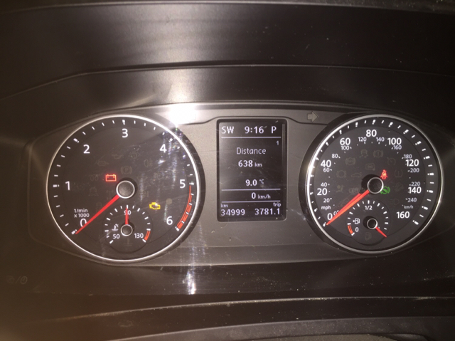

I did a brim to brim test today.
A message came through that our hosts over Christmas received a package addressed to me. It was for something I had ordered on 7 December for delivery to our rental house near Balestrate (Sicily). I had already advised my credit card issuer that it had not turned up and have received a chargeback.
The problem was that we are the other side of Sicily now. I decided to drive across the island to pick up the package. Soon after leaving I topped up with fuel and reset trip 1 data.
Shortly before returning I topped up again with 36.69 litres.
MFD shows 18.2 Km/l (51.4 mpg)
Brim to brim gives 17.4 Km/l (49.2 mpg)
MFD over reads by 4.4%
I think that 49.2 mpg over 400 miles is bloody amazing for a van. About 60% was on motorway, 10% on grade separated single carriageway (I.e. no lights, roundabouts or crossing traffic) and 30% on smaller roads including snarled up towns and a 2000 foot mountain pass. We had a mixture of dry weather and very heavy rain showers.
