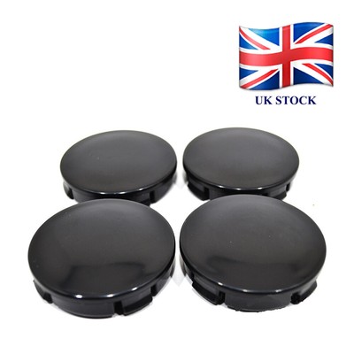

Hi, thanks for the info. Can I ask which cap you used as I'm trying to find a solution to help reduce rusty water running onto the wheels.

Its a bit hit and miss, what I did was measure the internal dia and the external and then searched Fleabay for ones that matched the dimensions.
Those in the picture are 55mm like this.
