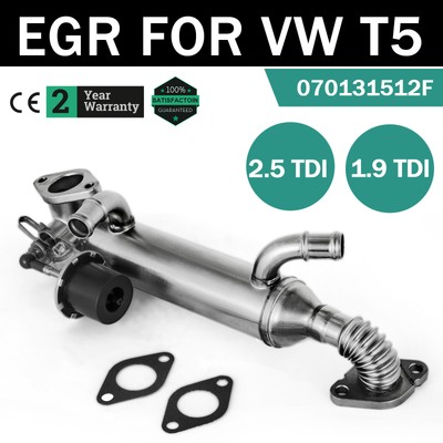

New one on eBay France.
Thanks WG! I wish it was that type, but its the more square variant, and seems to be much harder to find. Most often from the VW Touareg.
That one is different to the Parts Diagram for the 2007 2.5l Engine. But the Part Number changed in 2006 to the F variant.
Part Number changed December 2006 to the F variant.
Possibly you have the older D variant.

If that's the case then it should be replaced by the later F variant, as in the eBay link I posted above. Possibly @VW Guru can confirm.

The poster has the D type EGR cooler. Can it be replaced by the later F type cooler?
hi so having checked this morning there are only two options available from vw the 070131513D which is for autos and the 070131512f for manuals. The 070131513d still exists and is available from vw the 0701311513F does not exist on any of the factory systems
