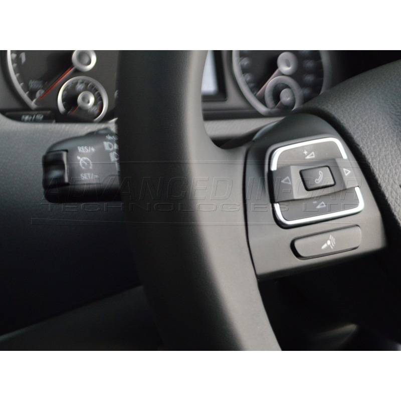

Edit - there is one here for VW. Semi-integrated though, essentially sits outside your current kit (ie not on the Dash, just the stalk).
Easy enough. EBay the stalk/loom then sort it via VCDS. Done it on my Golf.
It can , like sidepod said . There’s a guy in the north east who sells the kits on eBay . Or you go and see him in saltburn? He’ll fit while you wait.. 2-3 hours as I remember. Factory fit look with dash indicator and everything. Faultless .
VW Direct, thats his EBay handle.
For a T5 you have a VW original cruise control kit including stalk and wirings and codings.

I just ordered an original stalk from VW. It cost me €100. A couple of wires to the right modules in the right place and 2 lines of code.
The hardest part was the wire to the engine ECU. This is located under the starter battery.
So yes, it is possible from VW for a T5 and T5.1.
