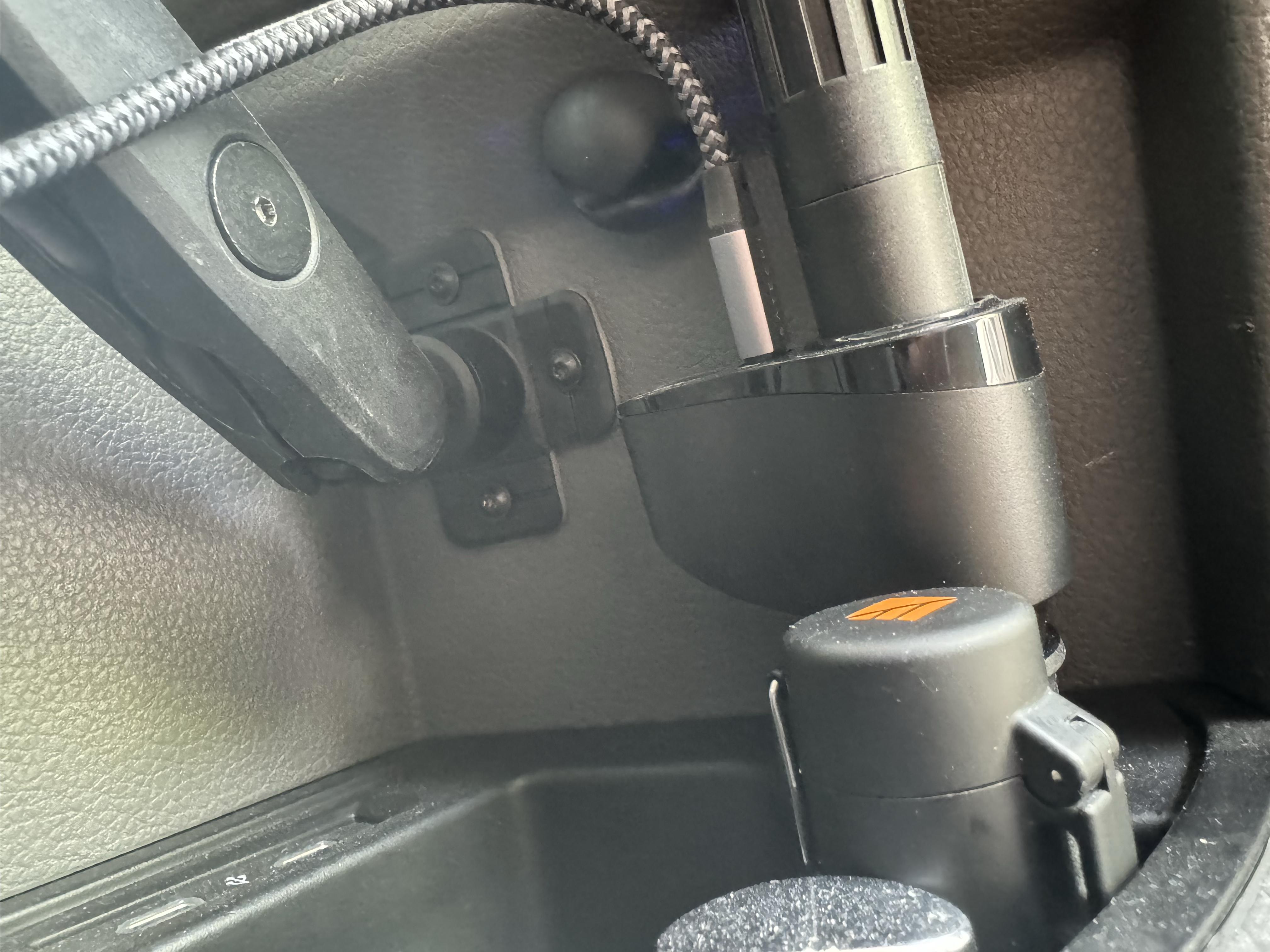

Here’s some photos. That long cable on the right is for the Dometic CFX12. Ignore that.
Thanks for that, appreciated. Do you know if the Quadlovk mount you have use a standard 1” ball mount? I’m thinking I can use a Ram or generic ball mount to attach it. Like you I’m keen to avoid a suction mount.
Not sure, I was considering the same but just went with all Quad lock parts to be sure as I needed something quickly for a long drive to Italy.

Is that a Quadlock phone bracket? If so do you recommend, I’ve been trying to decide between quadlock and a Ram mount
I’ve just got brodit (prezzie so didn’t pay crazy price) with fast charger built in has a special cigar 12v plug. 3m in place, hold iPhone max no probsIMG_6592.png
I’ve just got brodit (prezzie so didn’t pay crazy price) with fast charger built in has a special cigar 12v plug. 3m in place, hold iPhone max no probsView attachment 122693
I’ve had Brodit before. Good quality. But I have quad lock mounts on my bike, moto, and around the house. So this was my solution for the car too. The MagSafe case works great with or without quad lock mounts too.

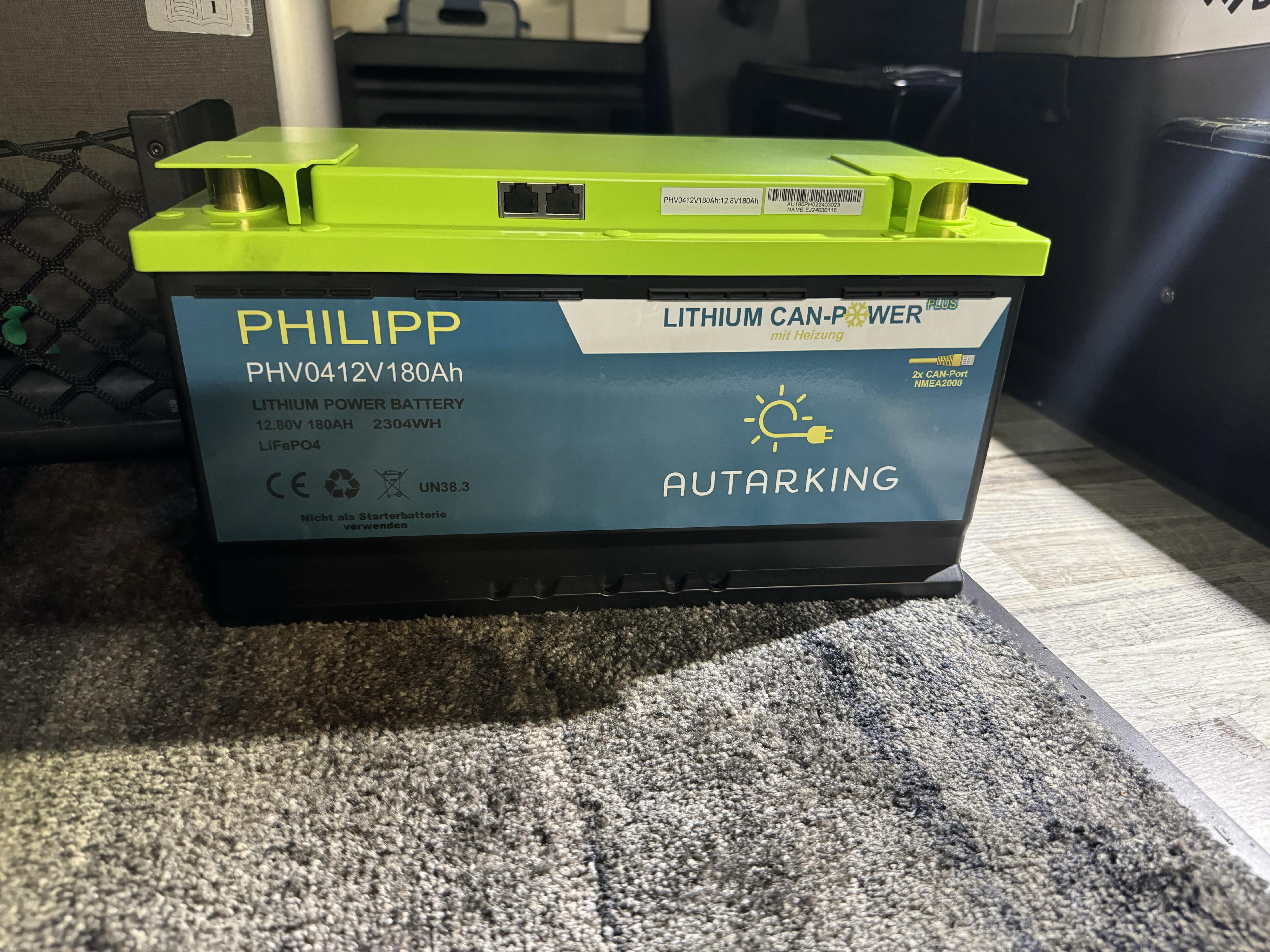

What are you using to charge them - a Victron DC to DC?
A Victron 100A BuckBoost. We managed to install it under the drivers seat along the backside but had to modify the frame slightly. One of the new Orion 50A’s would suit most people just fine though! My small issue now is the Transporter has an alternator of 180A and when the starter battery is charging, the BuckBoost is cranking full power and the compressor kicks in for air suspension I can hear a voltage drop with the compressor. Not a huge deal as I can turn off the BuckBoost with a switch next to the steering wheel column. But I’ve ordered a Bosch 250A alternator to resolve that.
