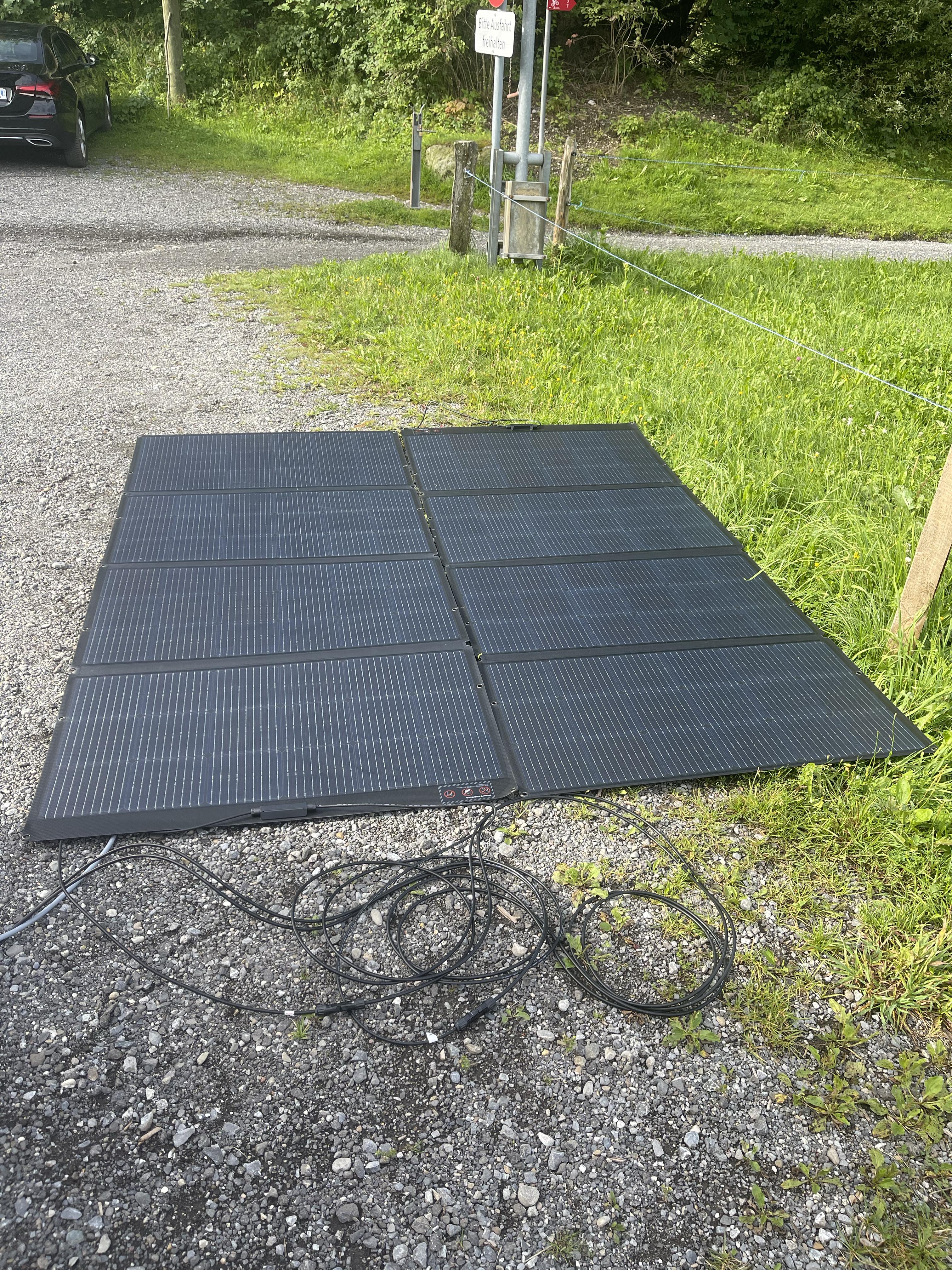

1*220 watt EcoFlow IP68 bifacial external panel
1*400 watt EcoFlow IP68 external panel
These EcoFlow panels are amazing and you get “watt” you pay for!

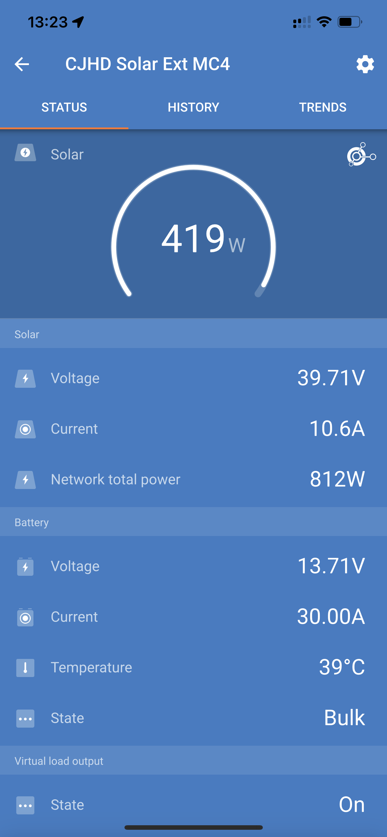

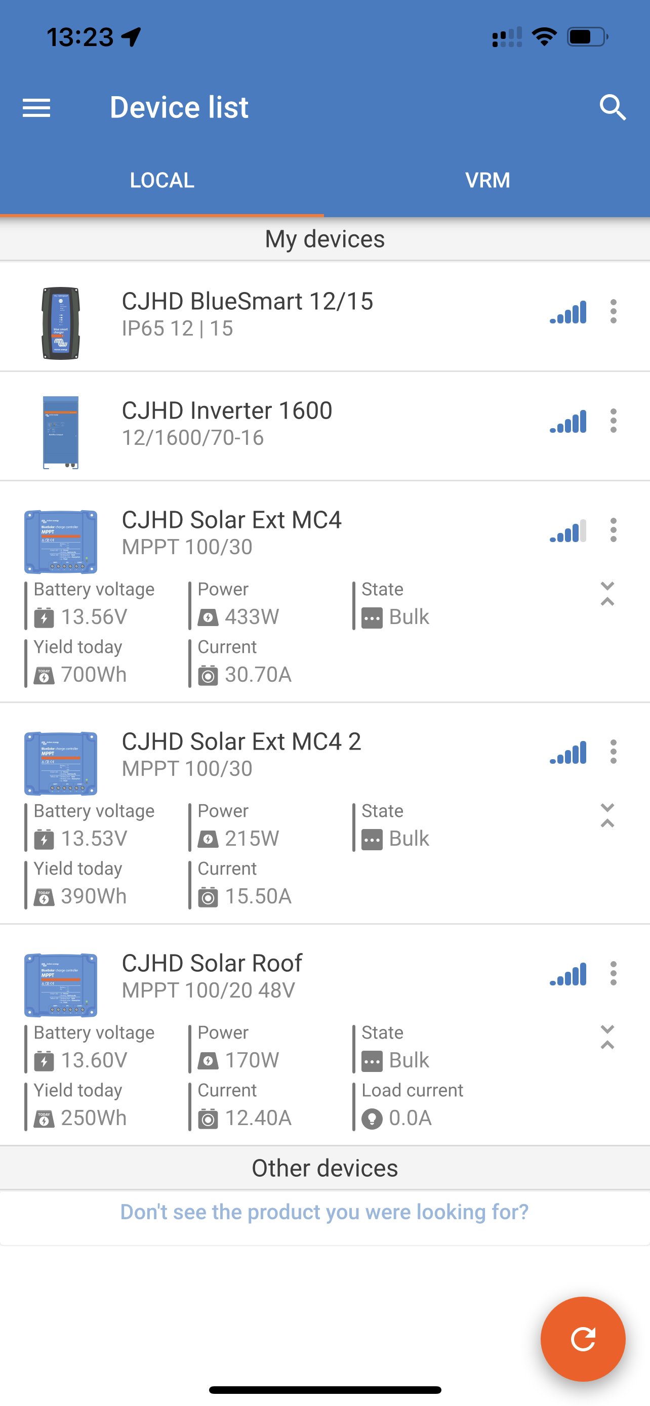

Look at these numbers:
812 watts of network total power (all panels concurrently) and the 400 watt panel putting out 419!
Above we can see a clear view of all devices. In this case 433 watts for the 400 panel and 215 for the 220 panel. Awesome stuff!

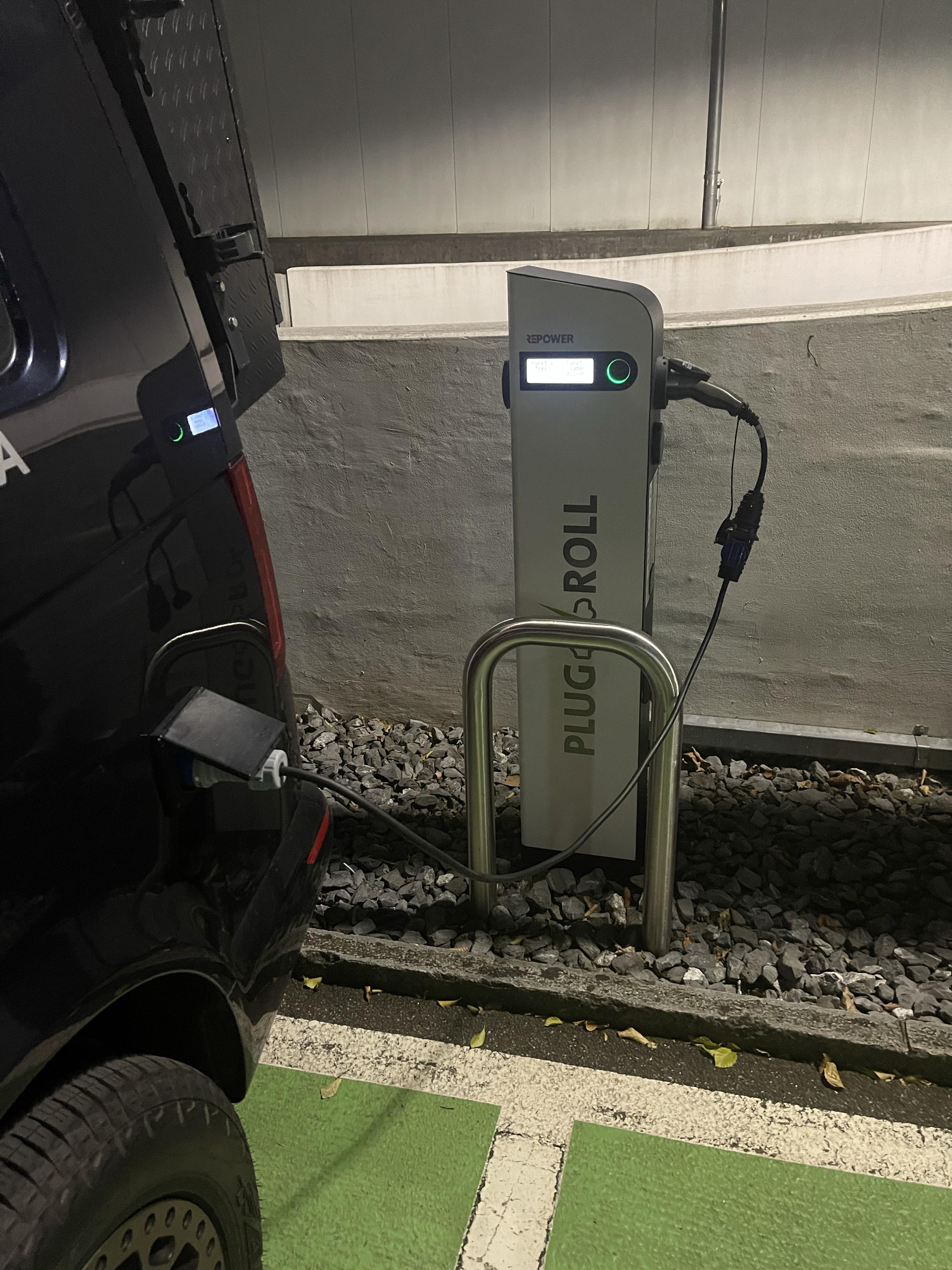

Finally got to test my Type2 to CEE 16A cable with an AC EV Charger. Works great! Looking forward to having this in the winter when Solar is meh.
