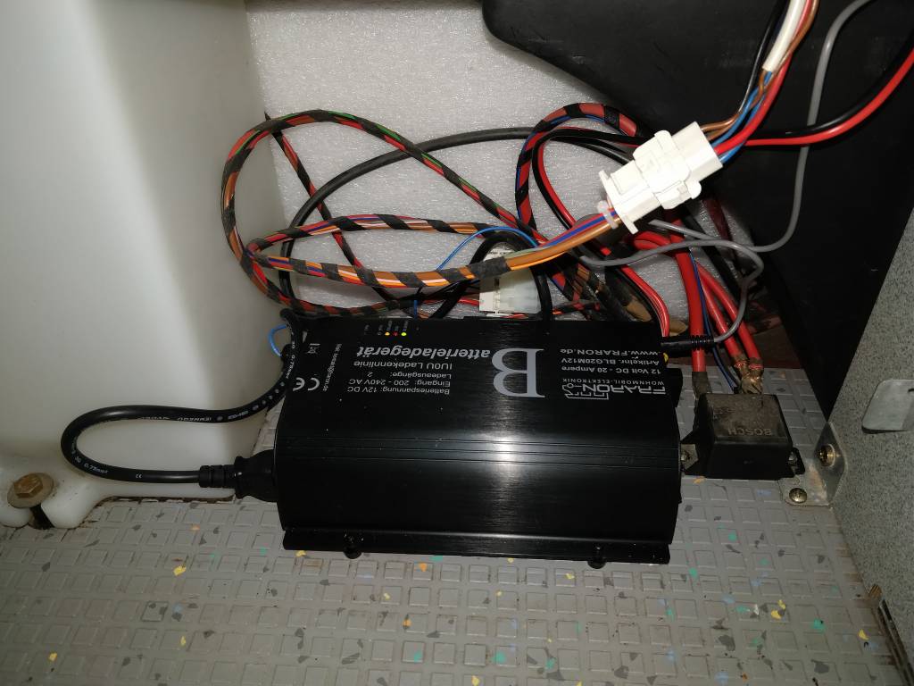

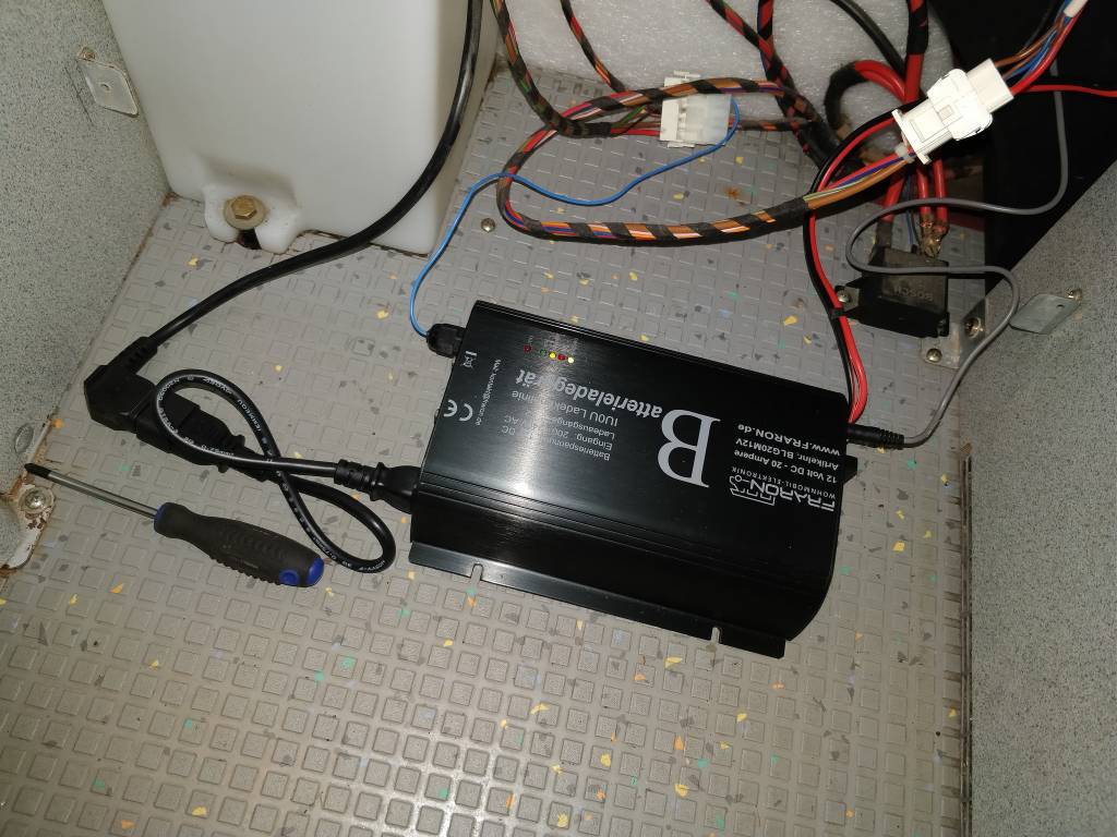

FraRon Installation. Now installed and working. Prong indication works on the control panel. Fan is a little noisy but probably no worse than the fridge running. In the end was fairly easy except for finding the correct (yellow tag) connectors for the thicker battery wires!!
Only one wire connection reused to the existing 6 way connector to the old westie charger - for the 'prong' indication on the control I presume. Don't know what the other wires were for? (except the battery link)
Rear of charger, the original power plug fitted ok so didn't need any of the adapters provided.
Front connections
Grey wire is the temp sensor connected to the neg terminal of the leisure batteries. (that's one of the unused connections on the 6way connection presumably!)
Battery connections, two positive connections and two sets of leads provided with the kit.
ArcticMatt suggests the extra one is for the vehicle battery connection. I have left mine off for the moment. Is it needed?
Leisure batteries connections. 25Amp fuse to the positive. FraRon recommended fused connection.
The offending blown fuse on the original charger. All the electronics looked in good condition so couldn't see an obvious failure and couldn't find anyone willing to look at it. Probably would have cost as much as replacing with the FraRon anyway (210 Euros including shipping- 7 days)
Front connections

Ok, have the unit. A couple of urgent questions. Some switch settings on the Fraron (see pic), which do I need for this battery (see other pic).
Cheers!
Have gone with 'Gel' and 13.5 float. Did some googling on this battery and it that seems to be the case...
Have flicked the switch and seems we're back online! Screen shows the prong and the battery charge is rising. It's true about the fan but think it will be mostly muffled by the covers.
Have seen already the phase move from 'bulk' to 'absorption', so I think all is good...
Fingers crossed no more troubles on this trip!
Cheers all for your input :thumb:D
