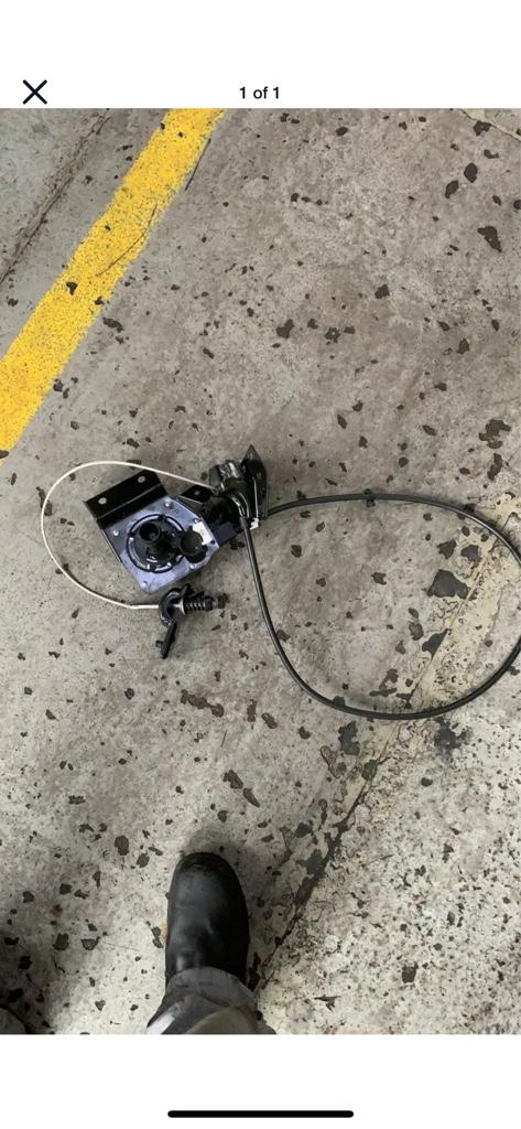

It’s an option listed in the UK but they didn’t seem to want to fit it when I asked early on and quoted £600 for dealer fit. They got very grumpy when I asked for part numbers at the selling dealer and said it would add 100kg to the weight. I’ve bought the kit off eBay and will take some photos when I fit.
Found it by searching for man tge crafter wheel carrier on eBay. Also needs some bolts. Full details of fitting are on Caliboard.de (German forum, translates automatically on google chrome).
The wheel carrier mechanism looks like this
It will add 30kg or so inc. wheel but seems like a sensible weight addition if you can spare some load capacity. I’ll post some pictures when I fit it, van not arrived yet

How did you mange to get the spare wheel fixed in the GC 600?
I can't see a "basket" or any other holders.
Regards,
Eberhard
There’s a bracket above the wheel with a cable holding the wheel & a winch for the cable fitted to the rear of the vans crossmember.
