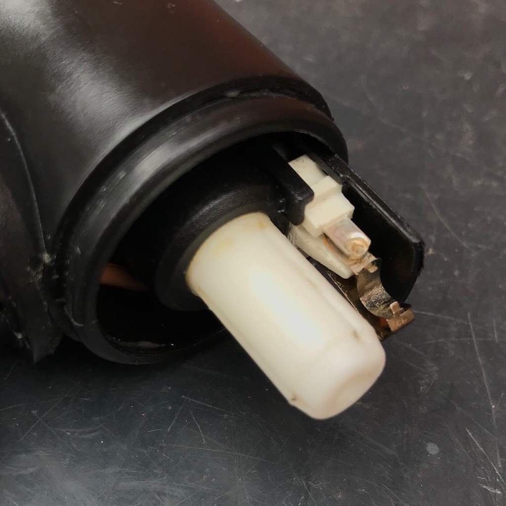

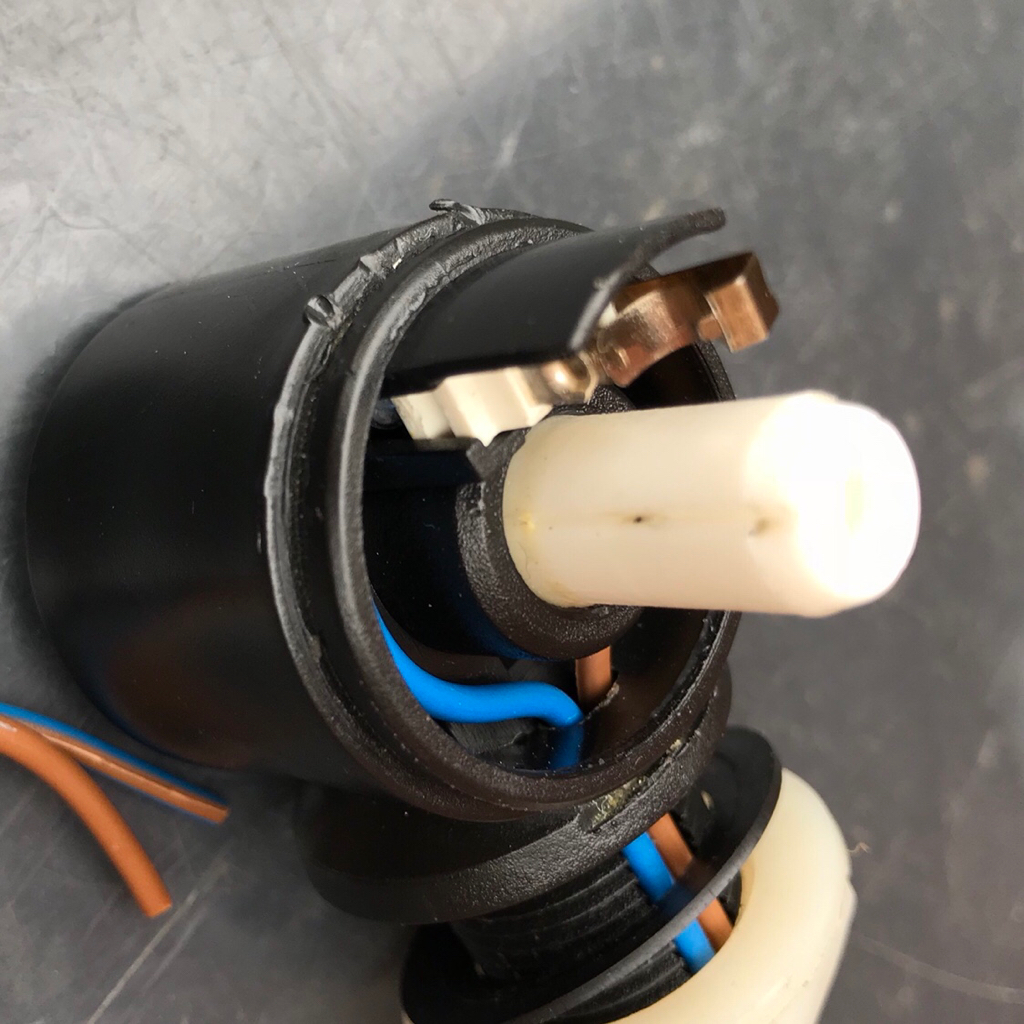

Hi all who've had tap woes. I've 'borrowed' my brothers California but the tap has been intermittent and eventually stopped working. I've checked the pump, and it's free to rotate with no signs of contamination. I then looked at the micro switch on the tap to clean the contacts, although when I pulled the handle off, a small brass clip has came off as well. I can refit it as I believe is correct (curve to the inside), but each time I refit the tap I can hear the micro switch, but then a sort of crunch and the clip pops off again.
Anybody else experienced this or know the correct fit for the small clip?
Hi
Did you ever find out the correct fit for the small clip ? We have a similar problem !!
Curve to inside is right. But the secret is to have the tap switched on. If it is in closed position the micro switch will just fall apart when putting tha handle back on the tap. Disconnect the wiring under the sink makes it easier.
Curve out!
Checked my micro switch today, the curve is out, not inside!
Would it be possible for you to post a photograph as I also cant yet work out how it goes back on ? I'm sure others have had this tiny part come undone.
Are these any use to you?
