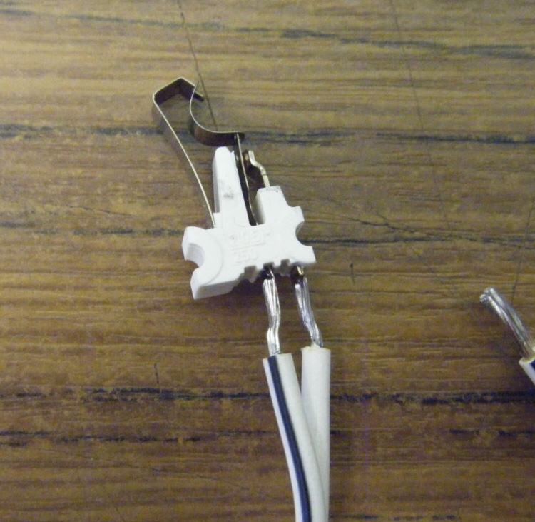

Found a website that sells new micro switches of this type. This is what it looks like…
Looks like “curve in” is correct. Mine is curve out because I obviously put it back wrong, but it still works :)

I also had problems with pump. Sometimes it worked, sometimes not. I checked everything mentioned in this thread and in the end it was the micro switch. Symptoms for bad micro switch I think are that if you try tap say 20 times, 10 times pump starts and 10 times it doesn't. I cleaned micro switch with sandpaper like
suggested in somewhere this thread. Now it works 20 times of 20 tries.

Just spent the morning replacing water pump, checking earth and finally realised my problem was the tap microswitch. The switch is broken - the tiny U shape spring contact in the switch is now lost. This solution looks interesting until I can fit a replacement tap but i'm no electrician and I can't see a physical switch on the box. Sorry if its a daft question but how does it turn the power to the pump on/off?
Unfortunately you need a working microswitch in the tap for the relay to work. The relay is there to relieve the microswitch of having so much current running through it which should reduce the burning on the microswitch contacts that, most often is the cause of it failing.
