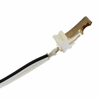

I've just replaced the microswitch for the tap in my 64 plate SE. My, more mechanically adept brother, helped me perform the task. After reading posts on this excellent forum, I decided to pay the princely sum of £4.50 and order the part rather than stump up £150 for a new tap (it seems VW won't just replace the micro switch). Reading other people's experiences and looking at some handy photos gave me the confidence to have a go. However, there are a few pointers I'd like to make...
Turn tap on and prise off ( carefully ) lever was fine.
Extract microswitch with screwdriver and then replace- no chance. We had to take of the tap and perform the removal and refit on a table. The plastic nut tightening the tap to the stainless steel sink is not easy to get to. You will also have tounclip the power and pull off the hose.
We ended up cutting the wires from the clip as we didn't want to disturb it and soldered on new wires from micro switch. We made a note which way round to position it as it's easy to lose your bearings!
The re assembly was quite straightforward and it fired up first time. We now have water!
I'll probably try and install a relay (as suggested) as that seems like a sensible idea.
That's a project for another time.
It's a fiddly replacement and I certainly needed the help, but it was immensely satisfying.
This is obviously a weakness owing to the number of owners complaining of issues. A skilled mechanic with all the tools would have the micro switch replaced in easily an hour. It's crazy to expect owners of such an expensive vehicle to have replace the whole tap!

Looks like “curve in” is correct. Mine is curve out because I obviously put it back wrong, but it still works :)
So I removed the leveler and the “bow” poppes out. Pump starts when touching the remaining metal parts. I managed to get the bow back in place after using sand paper on the two connecting things. Water came out of the sink, but the pump didn’t stop. Seemed like the connecting things still were connected. So took off the leverer again and tried to rearrange the bow and put the leverer on a hundred times but never managed to both have the bow in place and water arriving and getting the pump to turn off. In the end everything died (some sparks from now and then), and no more pump or water. Any suggestions on what happened and on what I should do next?
Check the 5A fuse under the passenger RHD/driver LHD seat, if not blown clean the tap contacts again and assemble correctly as per previous post photos.
I would still have the same problem, the pump is on continuously because the bow causes the two connectors being connected. Which is what happened before the fuse (probably) broke.
Might be worth buying a new tap then you don’t need to touch the micro switch. You can buy them in the Club Shop at a very reasonable price.
