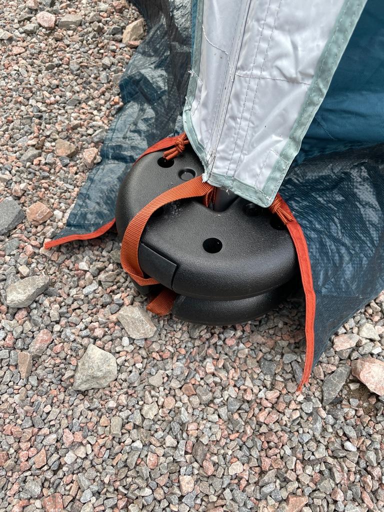

Having looked longingly at the cast iron weights in the professional markets to hold down the legs of their awnings I was shaken by the price. But then found a much cheaper (er, more economic option) on the internet.
We have been here at Canterbury for a couple of days and they seem to be working well and fulfilling their function.
They are heavy (concrete clad in plastic) but easy to store in the van and to carry around. They are not huge either. They were incredibly easy to fitView attachment 82938View attachment 82937View attachment 82937View attachment 82937View attachment 82937View attachment 82937View attachment 82937View attachment 82937
So far feeling chuffed with them.

Interesting. I normally have no problem pulling out pegs without a peg puller, although it looks an interesting bit of kit. The only place I experience difficulty is some Camping Club hardstandings where they have a rigid plastic sheet under the ballast. Looking at the number of other pegs left in these areas I'm not the only one. Hence my weights. Quick, easy, clean and adequate (although they did cost a bit more than a peg puller!)

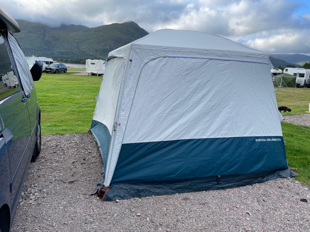

Currently at an undisclosed CAMC site in Scotland. No way there’s any rock peg on Earth going into this hardstanding, let alone worrying about getting it out again! Three corners of the shelter pegged down on the grass, weights holding the last one. Vindicated!

Never had a problem on CAMC pitches with a gravel hardstanding area, using quality rock pegs.
To be fair I haven’t either…until this one!
