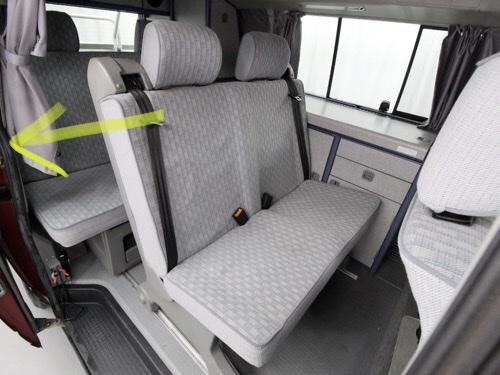

You just open the battery cupboard, left in the trunk/boot. Unscrew the screws first.
I don't know: no T4 westfalia california in Europe has this.

I got in there and confirmed what you are saying. Mine doe snot have a nice door like that but rather I had to disassemble things to remeove the entire wall there. But just the same, the bettery is there. I see your image shows a setup for two batteries. Mine has just one battery, but room for two. I think I will work a bracket to hold two, and install two in poarallel there. I mean, while I've got everything apart and being as I'd need to use two new batteries to do it anyway.
Thank you very much for the photo and your patience!
