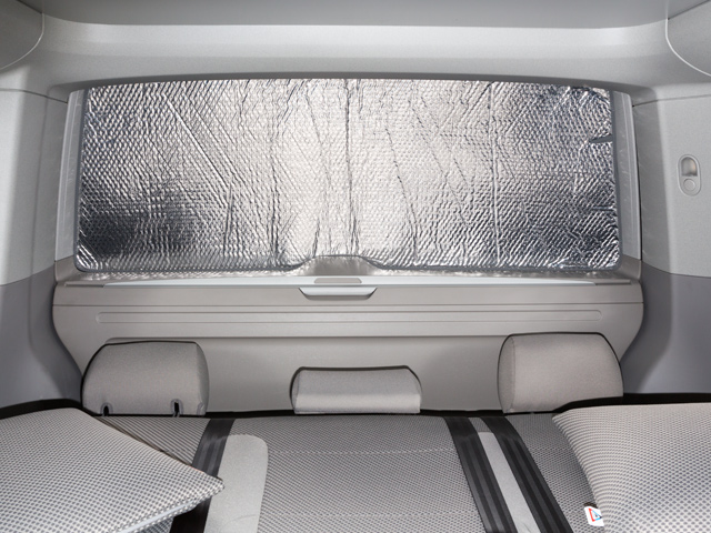

Ok I get what you mean, I’m also using a thermal screen the Brandrup one. Did you find that the screen stoped the water leaking ? If so Its looking like a exterior leak again, if you factor in a dehumidifier, heating on and ventilation ?

With single glazed windows I think you will probably still get condensation if it’s colder outside than inside, even with the dehumidifier and heat on. I don’t have a dehumidifier but I do keep it warm. It stops condensation not leaks. Do you get any condensation on the windscreen or tailgate screen in the morning? You would see it with blinds open.
Do Brandrup make a thermal screen for the rear window?
No condensation on the front screen, small amount on rear window occasionally, but mainly not. Here is a link to the Brandrup screen
Mine used to get lots of condensation, so yours may well be a leak. Thanks for the link.
