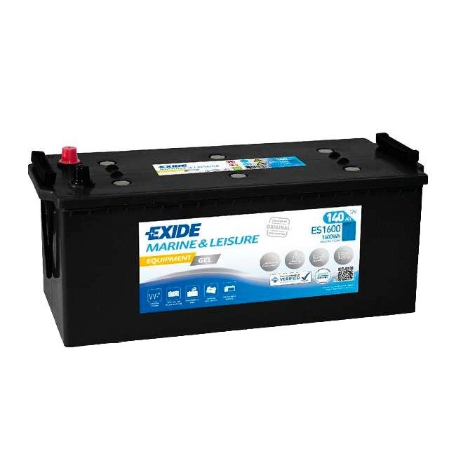

One big one or two smaller ones. Roll a dice. Makes no difference. One is easiest.
This is what you need.
Thanks sidepod.
Looks good but doesn't match what's in there. Does that matter?
