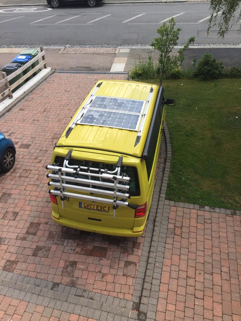

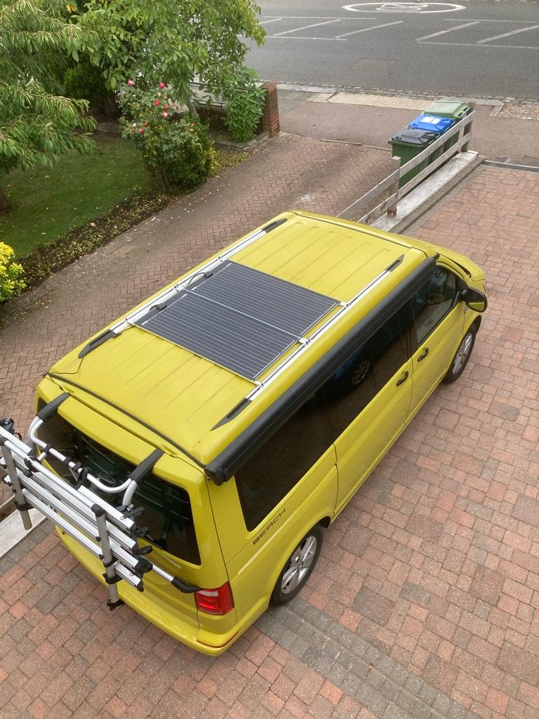

Old and new panels
My ocean windows don’t look anywhere as good as yours.
