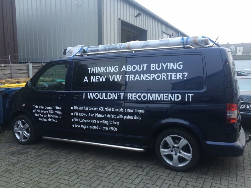

Nice job , is it yours , someone you know or just taken from the internet ...?
Funny but can cause some irritation by the " green thinkers"
As for me i got a forum sticker on the side ...on the awning actually ....looks much :cool:
Well not so much a protest as your pic but I've ordered Scooby Doo Mystery Machine transfers to put on the side of mine. For the kids. Unfortunately I have the transfers but no van as doesn't arrive until end of January.

Looks like it's a real problem.....am waiting on VWCS for mine to go into the garage for clarification as to why I have the same issues as that van. Looks like I need a new engine at 50000 miles.
Good luck with that,
I hope it's good news ... but it sounds serious :(
Is the piston ring fault a genuine problem then?
Yes this is a genuine fault, have a read on the T4 forum about it, I assume the reason we do not hear much about it on here is because it does not happen until you hit around 50-80k miles and most Cali's are low mileage. If my mind serves me correct the problem was on 2010-2011 vans? I may be wrong
